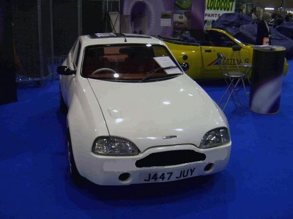

That looks excellent, I like what you've done with the front end. I've been trying to decide what to do with the front "grille" on my Gold since expanded metal is a bit boring - I'd looked at a lot of BMW MINI grilles since I work at a BMW dealership and some of their grille patterns would probably go quite well as a replacement.
My initial idea about reshaping the grille aperture into the traditional Aston Martin "mouth" shape is probably a bit silly and would possibly be more work than I can be bothered with. You've just shown me that better things can be achieved, with a little bit of ingenuity. Thanks! :)
Re: J171 NJO Cortez / 2+2 rebuild and modifications
Post by Jin »
funny you should mention the aston grill, even before i found a car to buy i toyed with the idea and i still like it, only issue would be the bonnet hinges would need re-locating, i may still do it when ive tidied up the rest of the car....
Post by DavidL »
Hmm...
Not as awkward on the Gold, it would only involve changes to the nosecone. I might still think about it once the car is back on the road, but I don't even have a timescale for that. It's one of those ideas that has just stuck in my head. :)
