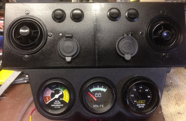

This is the dash board that replaces the old Metro heater unit:
As you can see there are two fresh air vents plus switches for: heater, fresh air, extractor fans and engine fan override, in addition to the new gauges.
The amount of wiring that has built up surprised me when it was done !!

Re: Mk 3 Q705CPF
Looks tidy but not much color coding going on.
Re: Mk 3 Q705CPF
no, but all labelled !!Hans Efde wrote:Looks tidy but not much color coding going on.

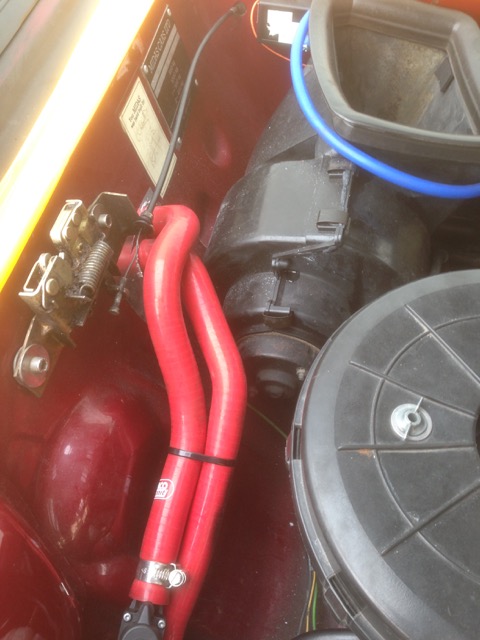

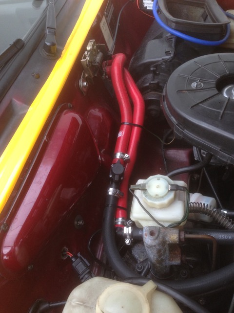

Latest photos of new heater plumbed in.
I had intended to make the Z bend connections in copper with soldered joints, but the pipes coming out of the heater were an odd size, so I made it all up in rubber and plastic !!
Now I need to add a bleed valve to the top hose and get rid of the airlock !!
Dave

Re: Mk 3 Q705CPF
That's a good routing. My hoses are sitting slightly too high in the engine bay and indeed the upper hose will trap all air and the heater stops working.

Re: Mk 3 Q705CPF
The bleed valve works fine, I have it as well. When all is cold I open it. Since it is on the highest position all air is accumulated. I push the hose down and the water pushes the air out. Cap screwed on again and air is gone. This works for a few trips, but to cure the problem I need to find out how much my expansion bottle can be raised. I installed it conservatively, so probably I can install it 2 or 3cm before hitting the bonnet. Hopefully that then will be the highest point in the system.
