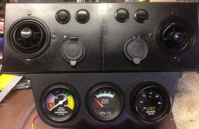

front panel
front panel
This is the dash board that replaces the old Metro heater unit:
As you can see there are two fresh air vents plus switches for: heater, fresh air, extractor fans and engine fan override, in addition to the new gauges.
The amount of wiring that has built up surprised me when it was done !!
Re: Mk 3 Q705CPF
Posted: Wed Mar 25, 2015 11:38 am
by Hans Efde
Looks tidy but not much color coding going on.

Hans Efde wrote:Looks tidy but not much color coding going on.
no, but all labelled !!
