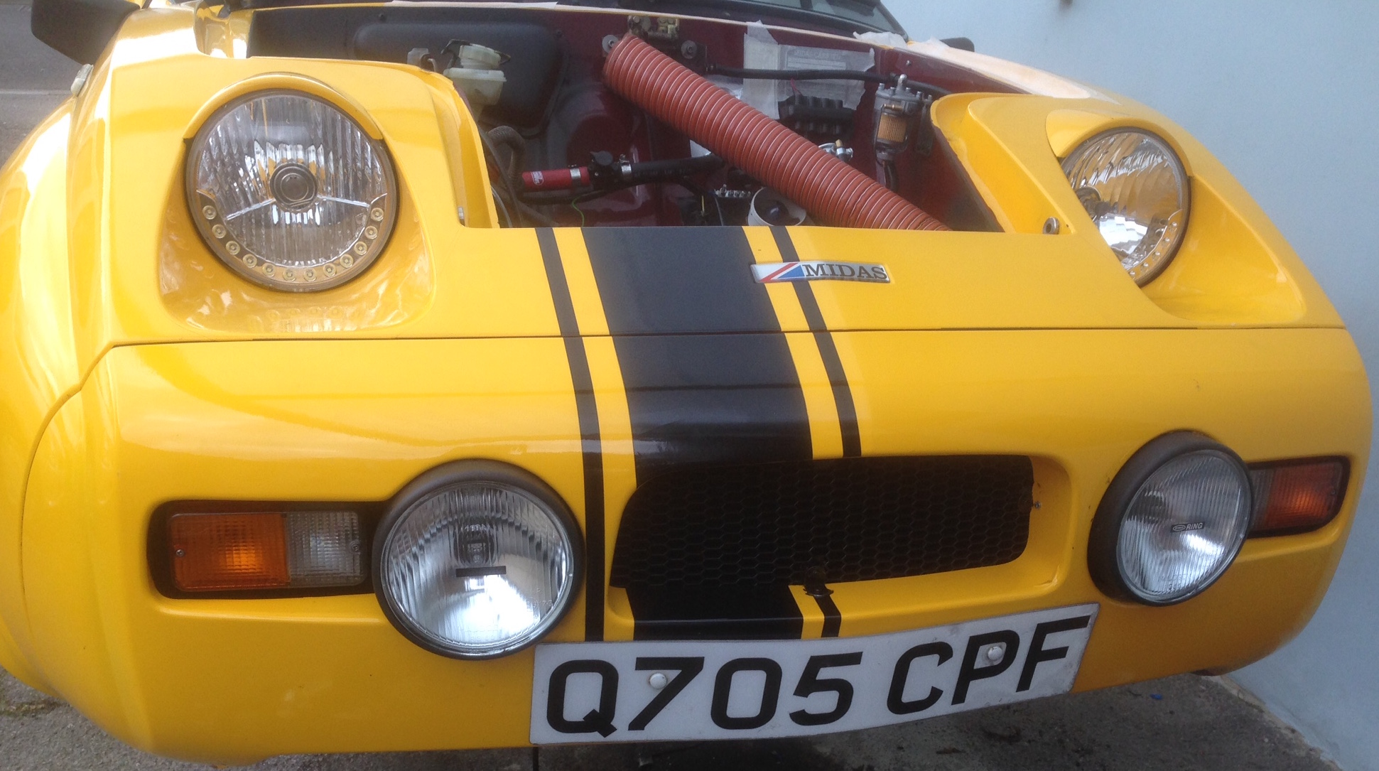

While I had the front of the car off, i took the opportunity to replace my broken Cibie driving lamps.
These are mounted on the bumper and NOT on the monocoque as per the Cibie's
As you can see they are not recessed any more !
These are 6 inch RING driving lamps from http://www.cbsonline.co.uk
Of course, they have yet to be aligned correctly.
