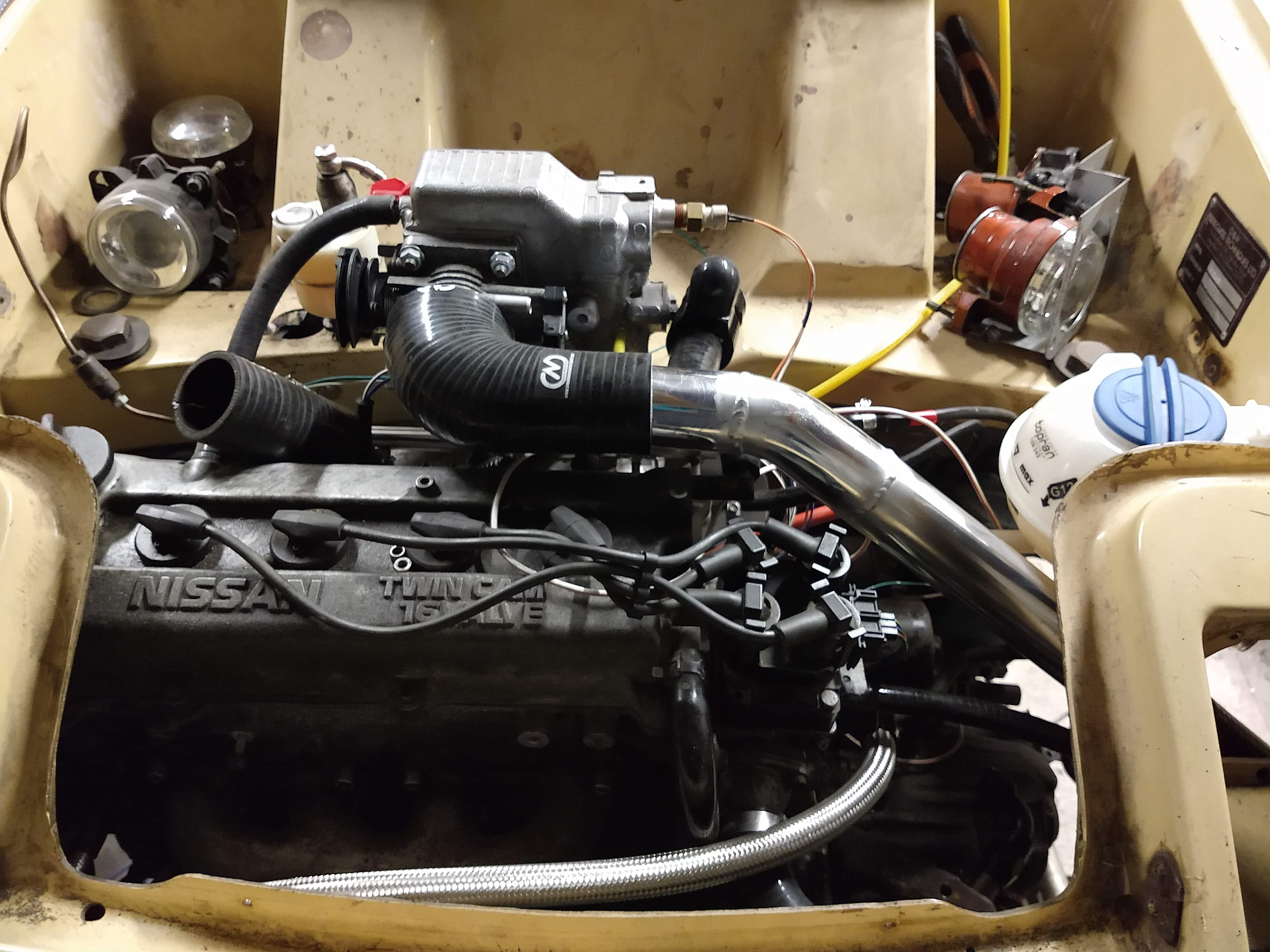

Good choice on the expansion tank, I did the same and it's mounted in pretty much the exact same spot
- IMG_20190101_165422282.jpg (1.2 MiB) Viewed 26619 times
