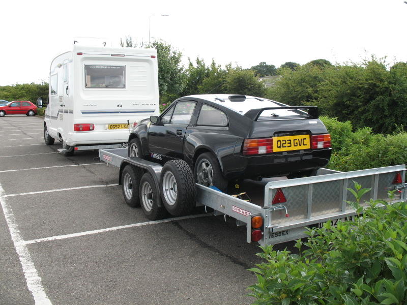

Hello and welcome to the forum Patrik. I bought the car off Geff, and then sold it to Ola when illness prevented me from driving and working on the car.
I had trouble getting oil pressure when I got the car up and running for Ola. As Hans says try pouring oil into the block via the pressure relief hole, that did the job for me.
The car had quite a few issues that needing resolving, and I just didn't have the energy or enthusiasm to do them. It was always a huge drinker of oil, a pint every 250 miles, but it didn't seem to smoke that much :?
I personally would not fit a sunroof. The brake light housing on the roof is supposed to help with the through-flow of air.
I regret selling the car every time I see it, but it does need changing back from the extreme build point that Geff built it to.
This was the last time I saw the car.

Thanks for the answers to my questions. But the answers gives me more questions. Why is my car famous? The rear wing is a custom-made thing, what I was told by Ola (previous owner) it's a Mercedes 190 wing that is modified. But I did not get it to work right when the wing is higher than an original 190's wing. Could it be that it's from a 190 EVO 2. So that makes my car special. Is there anything else that makes my car special and famous?
In what way is the car extremely built?
I've never driven the car, and no other Midas either.
As I wrote earlier, I have thoughts to mount sunroof in the car, Webasto Hollandia 100. Large glass surface and thin rubber strip, have emailed with a supplier here in Sweden and found out that they are made for a roof thickness of 0.8- 1,2mm. The car in the picture has a sunroof that resembles a Hollandia 100. What is your manufacturer of your sunroofs?
