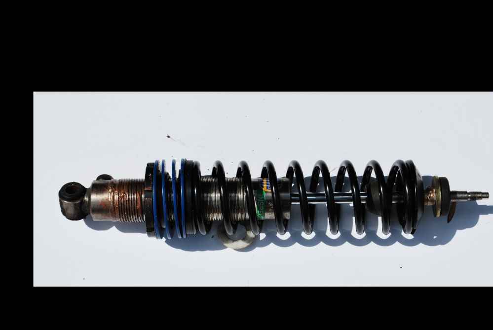

Here's a photo of the currently supplied Midas spec GAZ damper next to a shortened AVO one.
Here's an option with perhaps a run-flat spring of just 4lb/in
Copy of DSC_0340.jpg (87.09 KiB) Viewed 13677 times
