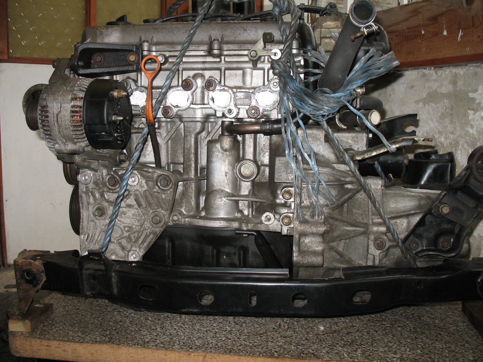

Last time I checked it it will fit.
npp 015 - Copy.jpg (1.13 MiB) Viewed 30006 times

Stuart wrote:Last time I checked it it will fit.
Are you doing the conversion as well then? I'm hoping i'll be able to find a 1.3 beater so I can just swap out what I need and sell the rest for scrap

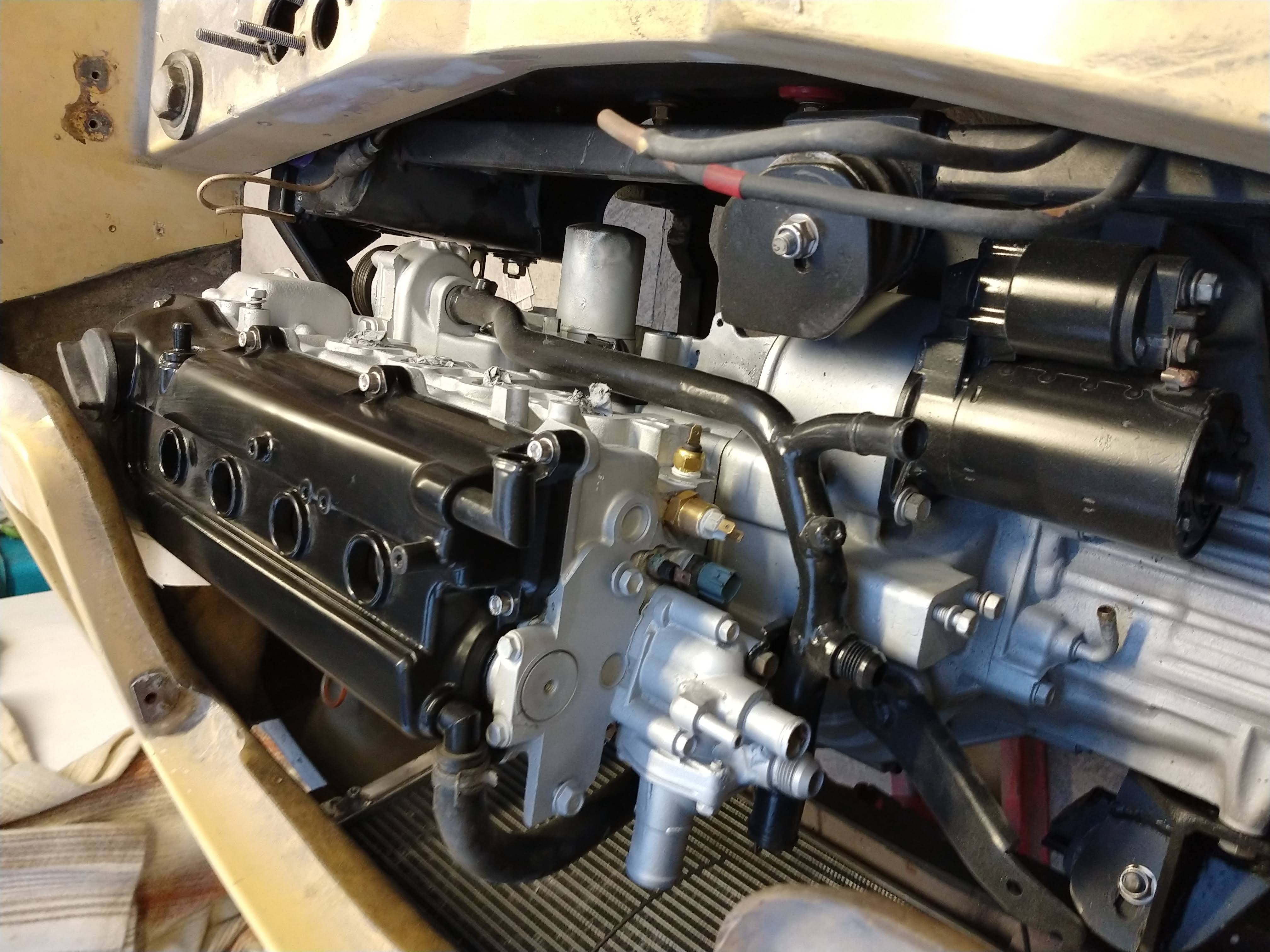

I've got one in my MK2
Nice 1. Was much work needed to squeeze it in other than tweeking the subframe?

wolfie wrote:
The engine encroaches into the o/s headlight so that needs a solution. The rest is just subframe mods

l_jonez wrote:
wolfie wrote:
I've been thinking about the headlight issue and to keep the frogeye look I may look at changing from 7" headlights to 5 3/4" so they can move forward without looking like a choking frog
