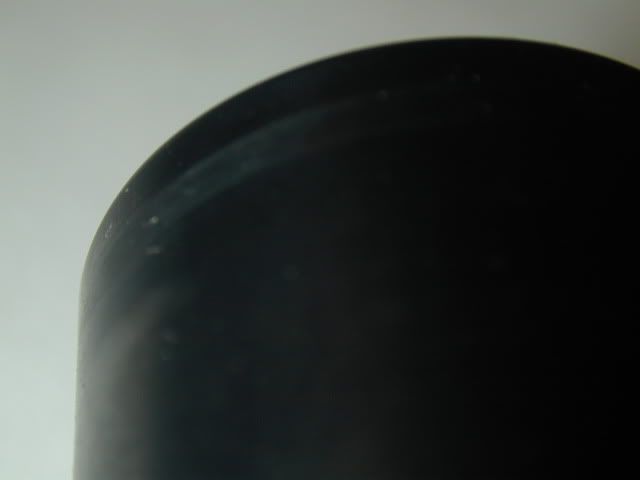

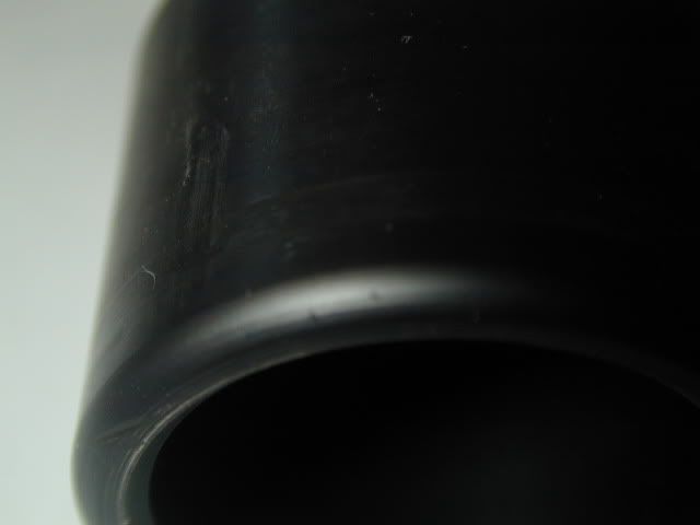

Postby Geoff Butcher » Thu May 26, 2011 8:09 pm
I wonder if this is anything to do with my sagging pedal problem. These pistons are from the recon caliper I fitted a few months ago after shearing a bleed screw.
It doesn't show very well but there is a distinct witness mark where the seal sits. It doesn't go round the whole circumference but it's on all four pistons. I've seen plenty of rusty pistons but never one with a wear mark, if that's what it is, and not after a few months. I've also never seen this dark grey surface finish, they're always shiny, which I take to be electroless nickel, unless they're stainless of course. Could this somehow be acting as a one way valve and letting air in? Time will tell if the pedal starts dropping, but I don't think I'll be using these pistons again.
