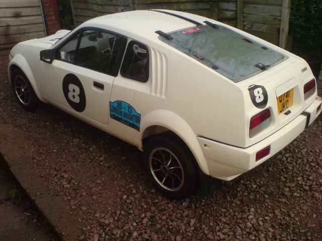

How tall are you? and am I correct in thinking you own this white mk2 as well as the one you're currently working on ?Image19xx Midas Mini Kit-car - White by Clive Barker, on Flickr

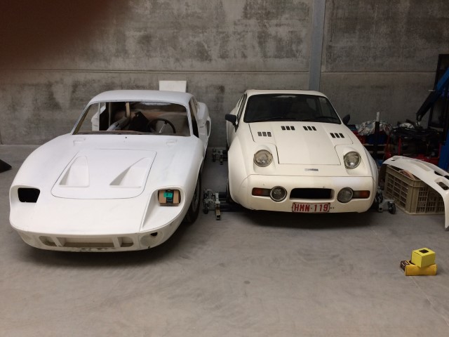

Yes the Midas MKII is mine , but it's also the car where I am working on , how did you know that could be my Midas ?
I have sold the Midas MKIII of Alan last year to a good friend , but I own anohter MKIII who was since +-2004 in Belgium on the road .

I had thought you had another mk2 that you're working on, didn't realise it was that one, Brain a previous owner moved the subframe over and also spaced one side out a bit.
