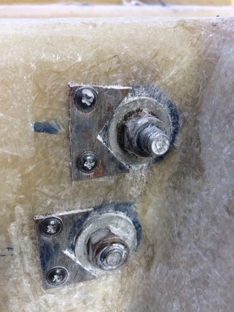

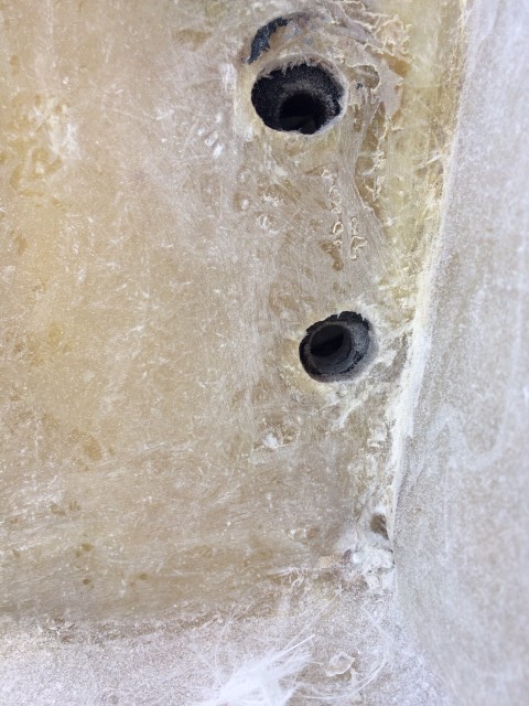

Postby ilmung » Wed Oct 03, 2018 9:31 pm
Hi Stuart
In annex you can see what I mean what Brian did to fix the rear frame at a certain position .
The place of the system to fix the bolts are just near the middle tunnel , right side , seen from the back of the car .
And you are right ,Brian did change the position of his rear frame some mm ( +- 6 mm) to the left , also seen from the back of the car .
IMG_0235 (Small).JPG (114.57 KiB) Viewed 6271 times
IMG_0234 (Small).JPG (109.29 KiB) Viewed 6271 times
IMG_0232 (Small).JPG (113.14 KiB) Viewed 6271 times
