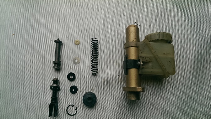

Clutch master cylinder
Postby streetsy » Sat Oct 18, 2014 6:50 pm
Todays little job, clutch master cylinder. Stripped, cleaned, sanded, primed and painted then re-assembled with a rebuild kit.
Clutch rebuilt
Clutch master rebuilt.jpg (116.03 KiB) Viewed 37824 times
Clutch rebuild kit
Clutch master kit.jpg (143.32 KiB) Viewed 37824 times

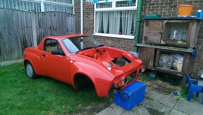

BKA 689X Update
Postby streetsy » Fri Nov 14, 2014 11:09 pm
I haven't updated for a while so here goes. The car has been stripped of the front subframe, engine, exhaust, all wiring, interior and metro heater unit. The subframe has been altered to take the mini coil springs as both hydro units looked in questionable order. the subframe and engine (albeit without a head at present) are both back in the car. the engine has had the gearbox replaced for one with a taller final drive (3.105 from 3.44) and a centre oil pick-up pipe. The cam has been replaced with a Minispares evo item along with duplex timing gears and a new oil pump. The head has had the ports cleaned up and opened out a little and has had a little skim to ensure it is flat. Single HIF44 carb has been altered according to the Vizard books. The rebuilt clutch master cylinder is refitted, the brake master cylinder was replaced previously so it has just had a clean up and lick of paint. The car came with a new radiator so I have fitted that along with a new slimline fan. The seemingly endless task of wiring has begun, I have been trying to conceal as much of the wiring as I can to leave a tidy engine bay. As for the interior I have seats and Clocks that I want to use and a centre console is under way but I am still undecided on what material to use for my dash and the centre console front, I am torn between Aluminium, burr walnut and vinyl, time and availability will tell.
