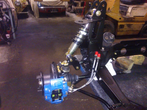

Thought it was time for an update.
I have been working on the front subframe fitting coil over front shocks. Hope it works as good as it looks.

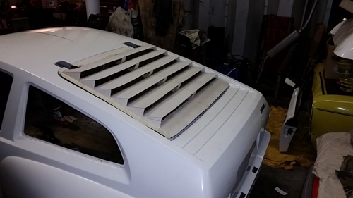

I have also made a pattern for a rear louver to fit on the rear window.
I don't like the flat rear glass. It looks like someone broke the original and just replaced it with a plain piece of flat glass.
It is only cardboard but I am going to cut it out of Aluminium and have it powdercoated black.
Everyone I have showed it to so far really likes it.

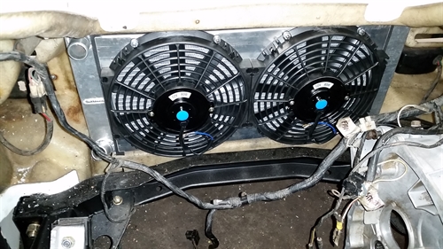

Custom made radiator with inlet and outlet hoses on the same side with split tank. Gets rid of that long top hose across the front of the engine bay.

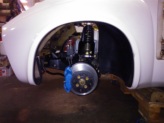

Front brakes fully rebuilt

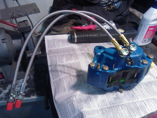

Front 4 pot calipers

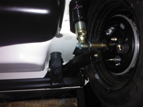

Rear suspension is all in along with fuel tank and lines.
