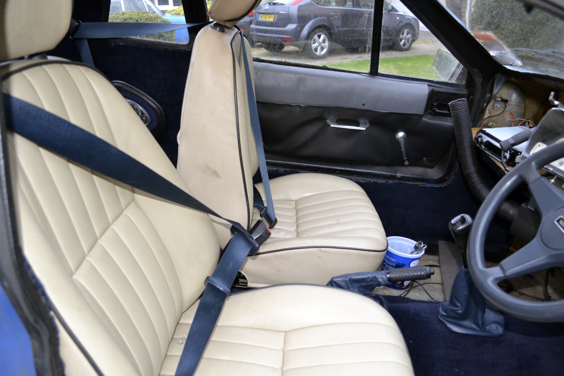

The Huntsmaster seats in my MK2 have seen better days. The foam would need replacing and the seats recovered. I have seen that Mazda MX5 MK1 seats fit with a little modification to the runners but as these seats are quite old now the majority of are showing signs of damage particularly to the right hand bolsters on the driver's seat. So, I wondered if anyone had tried fitting other seats with success. I have seen the following seats but as they have "wings" at shoulder level wondered if they might be too wide to fit.

I have MGF/TF seats in my Mk2 the fit pretty well if a smidge high in the base, they are the most comfortable seats I've ever tried in a Mk2 having over the years driven Mk2s with Corbeau, Ridgard, Hunmaster they were also better than the two types of Recaro's I've previously had fitted.
- _DSC0149.jpg (582.31 KiB) Viewed 11307 times
