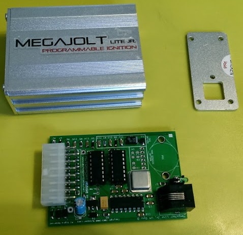

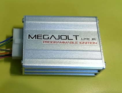

Having read up on the work involved in changing from TPS to MAP I thought I'd have a go. The transfer involves de-soldering one resistor and adding a MAP sensor two capacitors and one resistor. The resistors and capacitors are small, surface mounted items. Below are some pictures showing the unit as purchased, stripped down, the new parts (note: resistor out of square but is works and its tiny so its staying that way), the unit rebuilt with vacuum hose attachment and a picture of a capacitor on top of a penny for an idea of size.
Megajolt as purchased
Megajolt taken apart
Mega open.jpg (69.51 KiB) Viewed 7720 times
Size of components (1p for scale)
Mega Cap.jpg (32.91 KiB) Viewed 7720 times

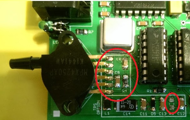

Photos to show the board, highlighted areas showing resistor R3 removed and new components added and completed unit.
Board with new components
Mega board done.jpg (87.34 KiB) Viewed 7718 times

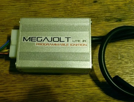

Rebuilt with vacuum hose fitted
