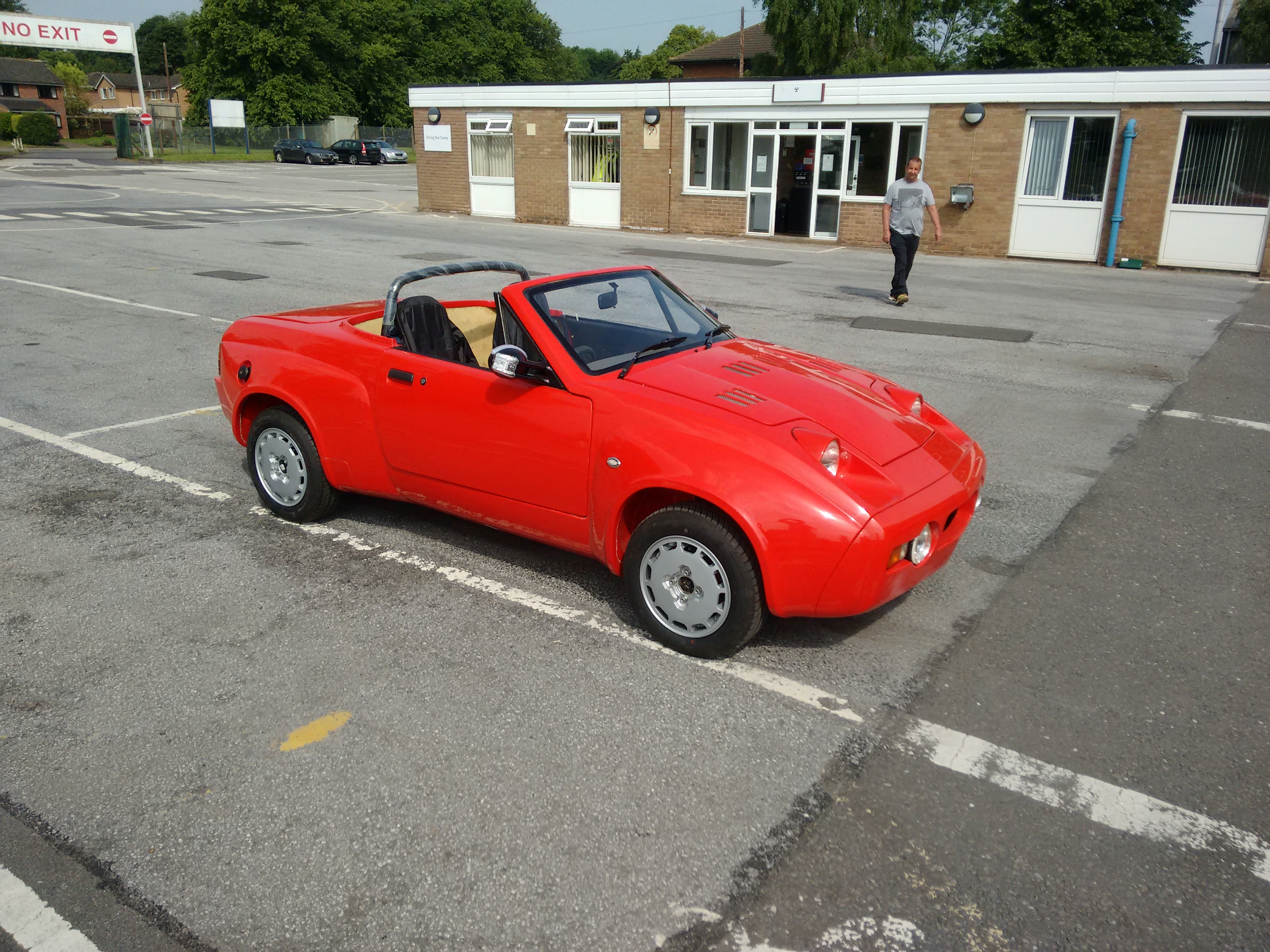

At the IVA test (June 2017)

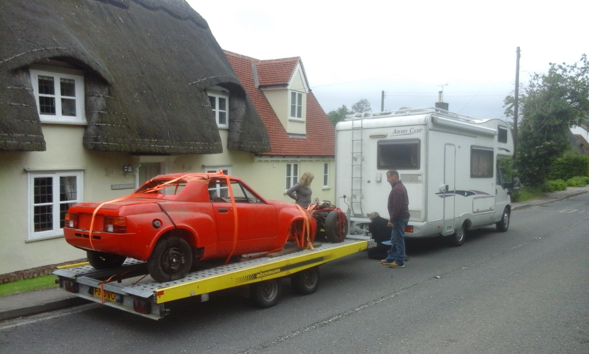

Collecting the kit (June 2016)
