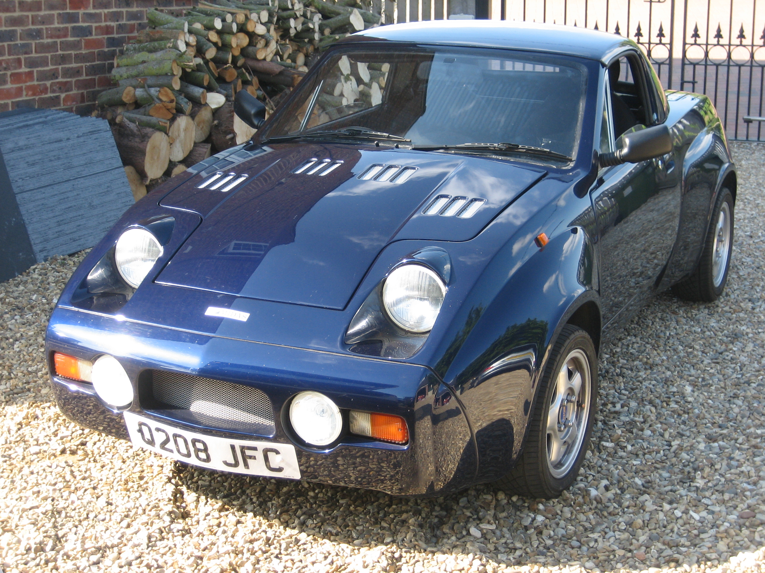

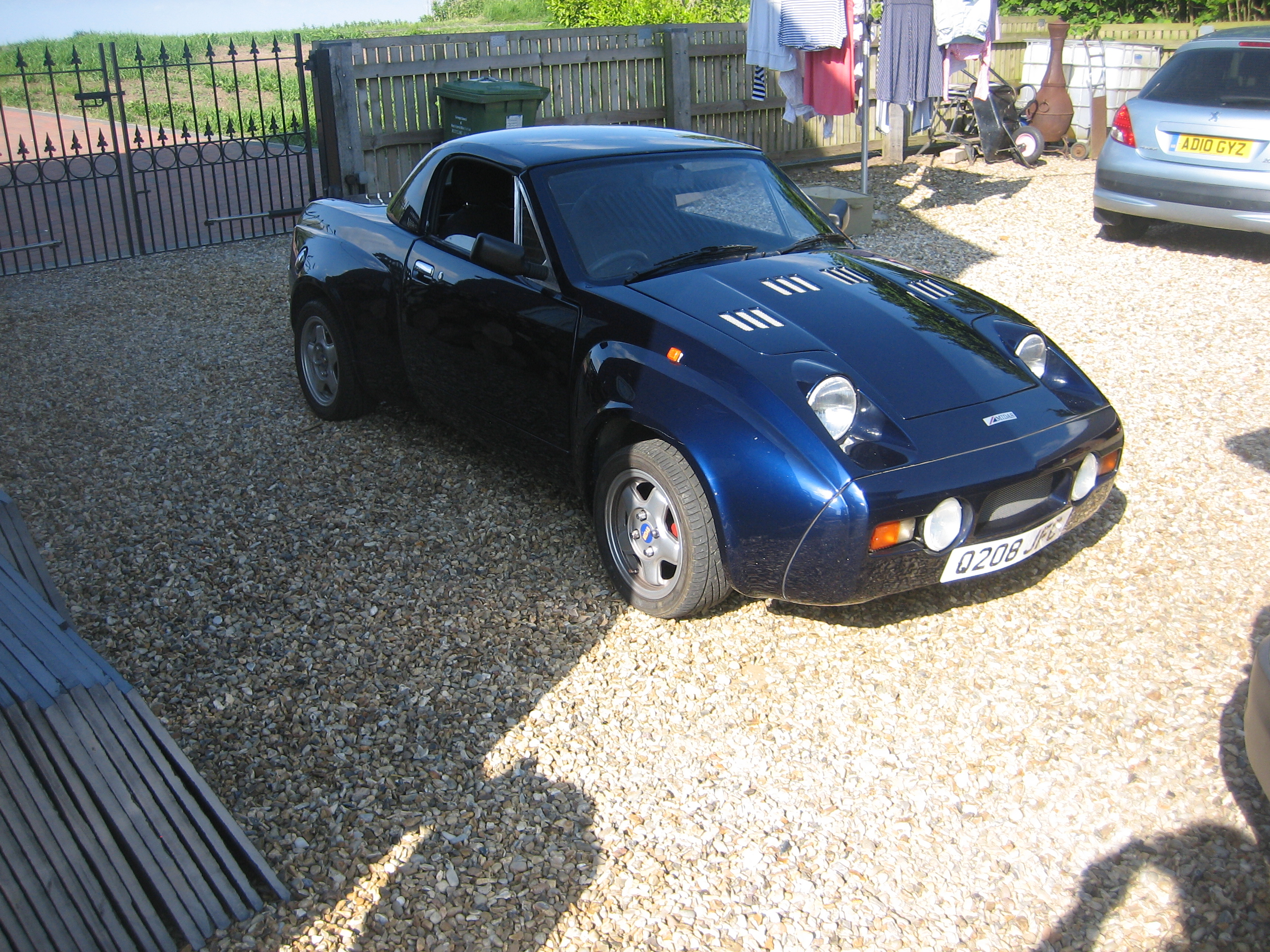

Here she is …..
Just got to get her going again.
Re: A returning owner - well hopefully....
Awesome buy, what an amazing color. Shouldn't be too difficult to get her going again. Alistair did a writeup on this forum how to revive a car that has been garaged for a few years.
