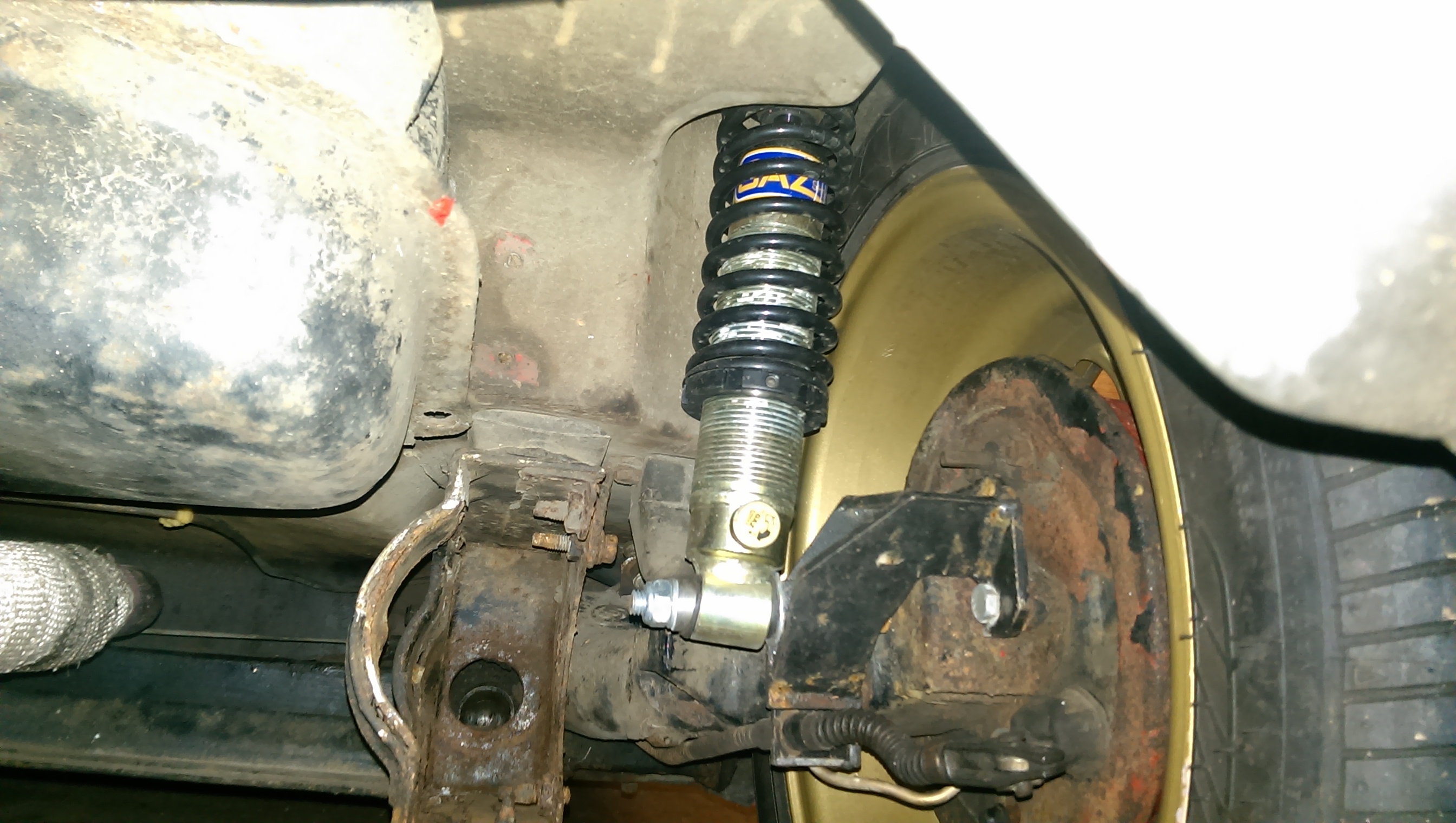

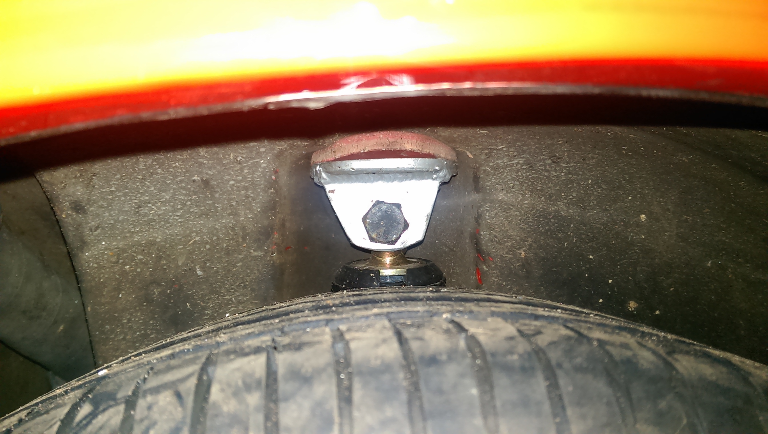

Photo from the side showing bracket I made with the red rubber to soften any impact should the suspension bottom out. The other photo is from beneath, it shows the Midas designed bracket for the lower mount and highlights how much I need to fit my new (not rusty) subframe on the back of the car
Underneath
Underneath
From the side
From the side

Nicely done job there Richard, I presume you can rotate the top mounts to gain easier access to the nut and bolt heads for removal by slackening the internal bolt.
The only thing that does surprise me in a negative kind of way is that the subframe isn't all polished to your usual standard there, as for those drum brake back plates, SHOCKING!!!! ;-)
Re: Rear Coilover Mounts
Post by streetsy »
Subframe is On the winter list, by spring it should be clean and bereft of any UN-necessary hydrogas support bracketry
