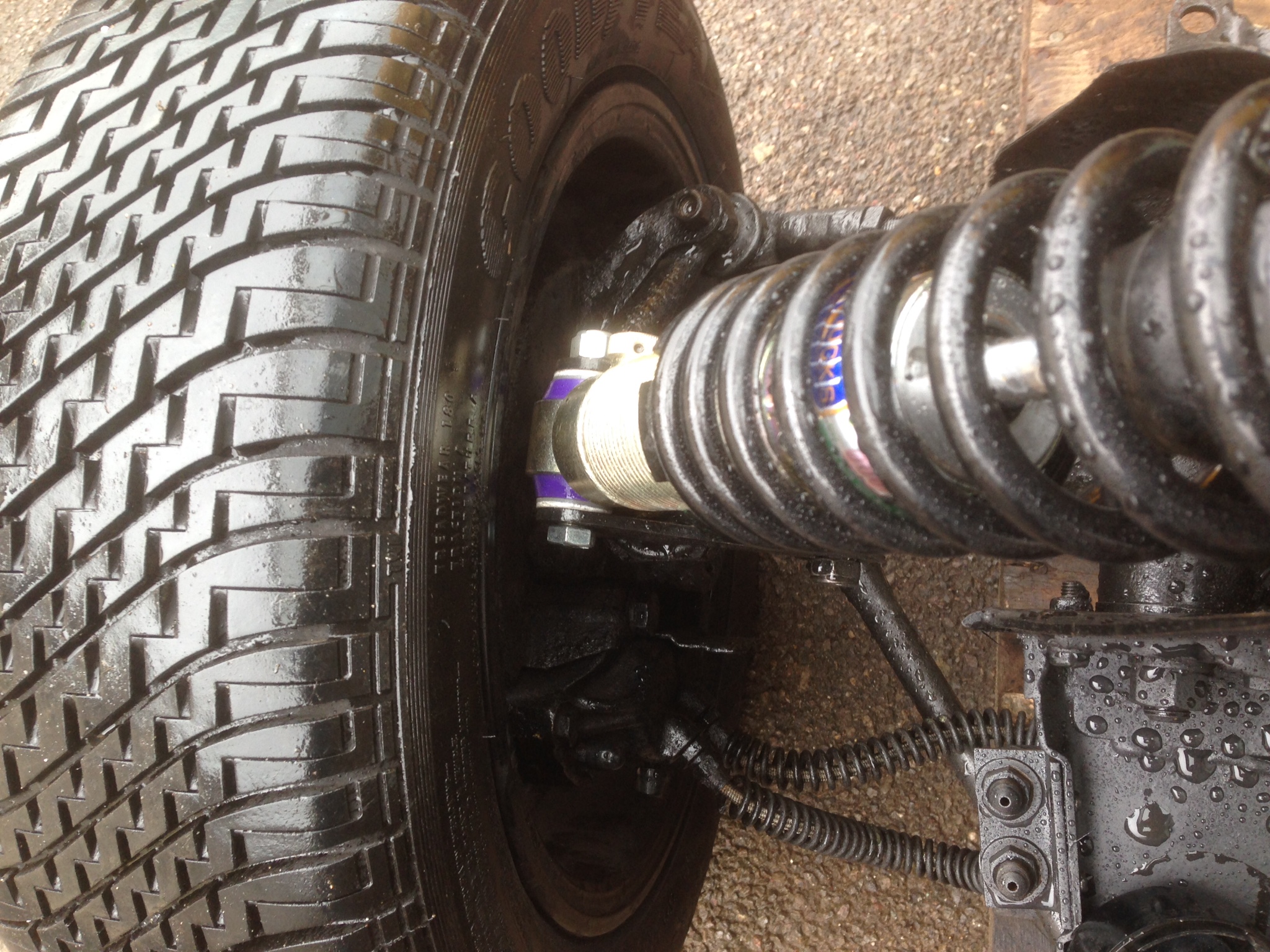

Sub-frame with new suspension parts all painted up and ready for the engine to be installed.

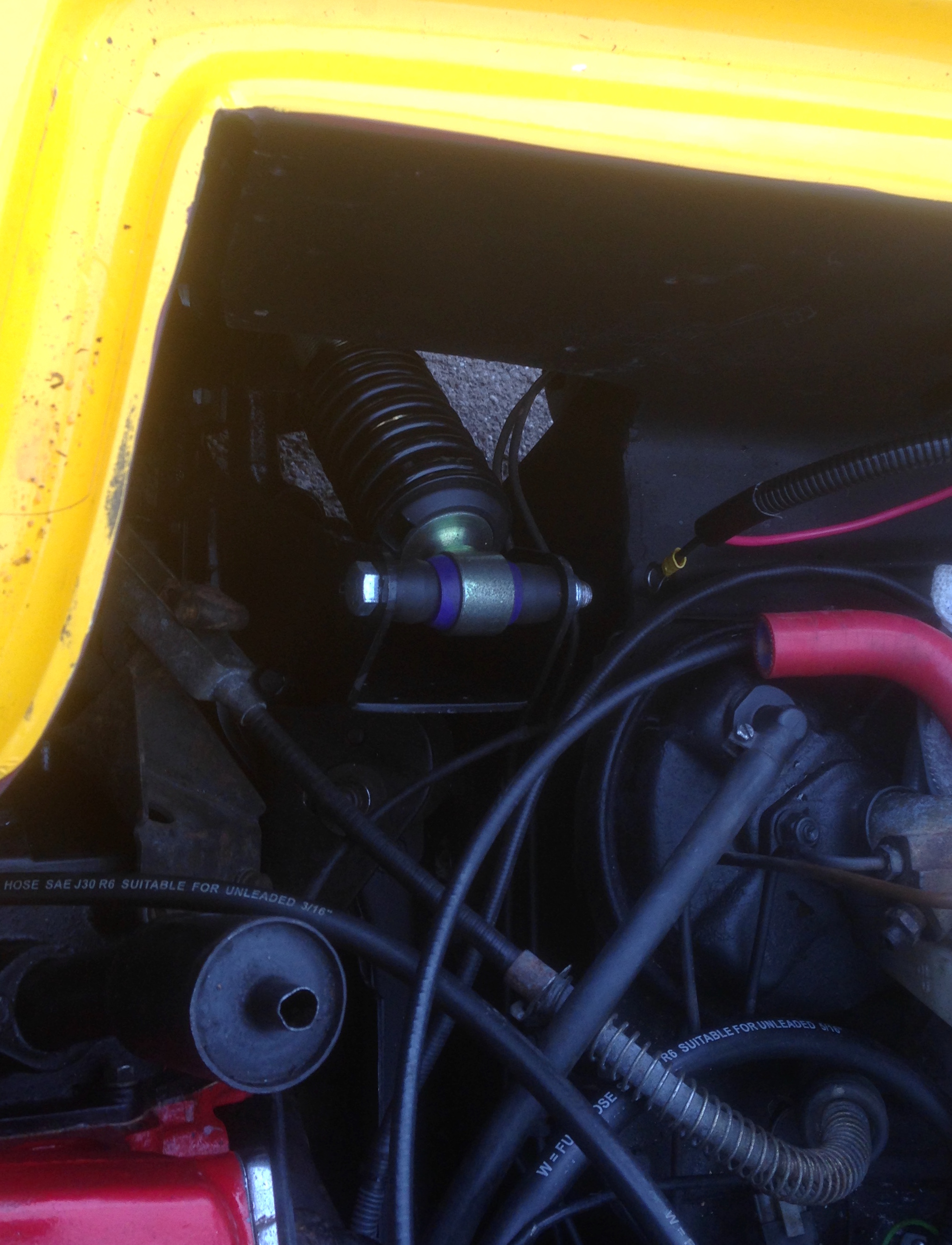

Post by axshack »
thanks for this info. I have decided against moving the battery after all, and as for the servo, well I have a newer one that came with the subframe, so I will probably fit it as I think the top of the suspension mounting will just squeeze in (keeping everything crossed) !!

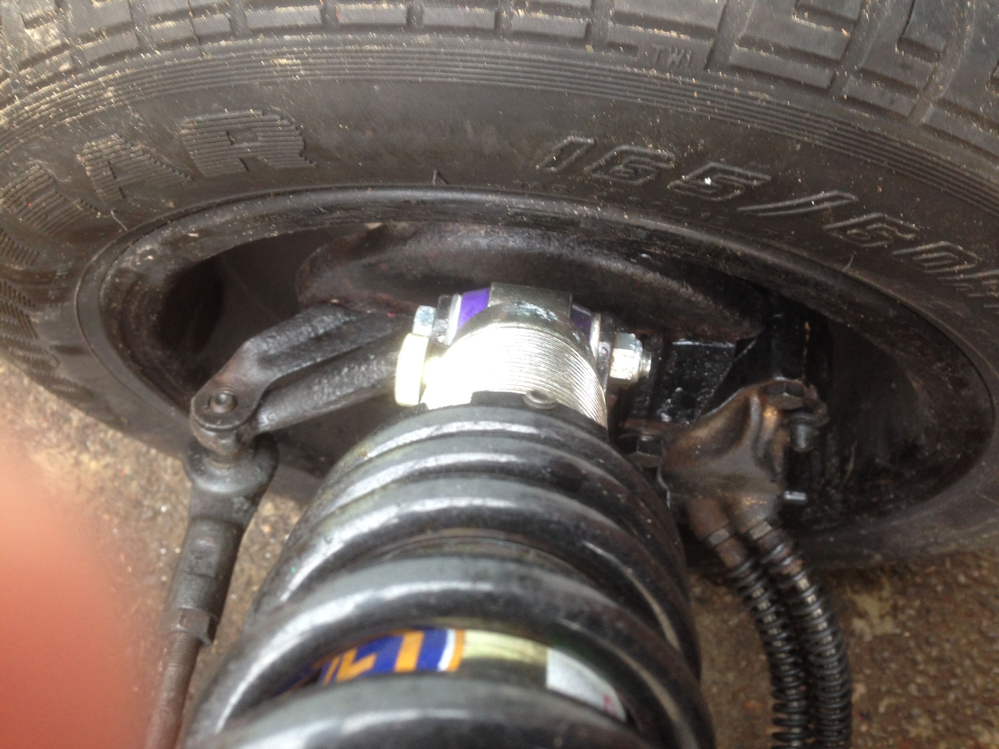

Post by DavidL »
With the bracket for the lower end of the damper being above the top swivel, was there much of a problem getting clearance between it and the wheel rim?
Re: A different Coil-Over solution !
Post by axshack »
very good question DavidL, and it worried me for a while as I had not, as yet, fitted the wheels!! but just did so and there is at least 12mm clearance between the bottom of the damper mounting and the wheel rim - phew !! :)
Post by axshack »

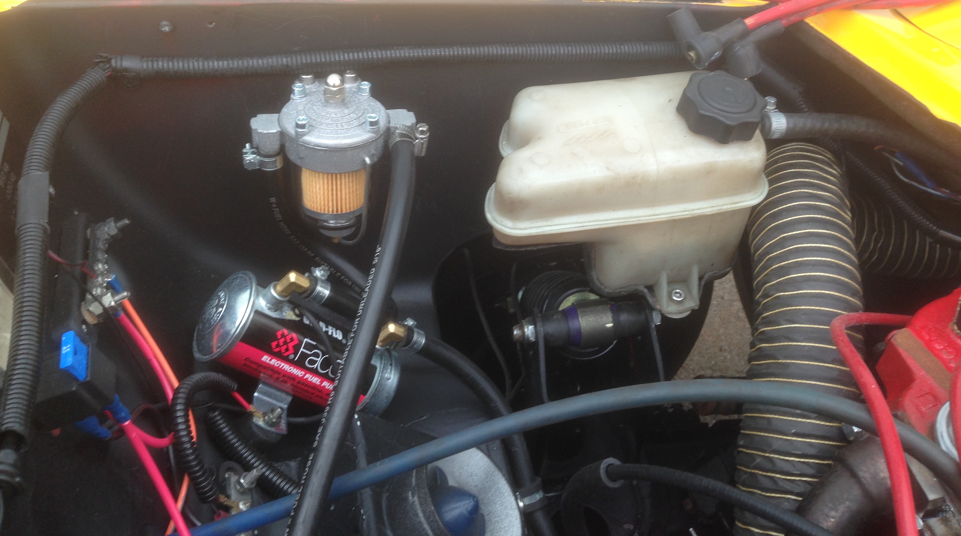

Today, we managed to get the engine onto the subframe and both back in the car...bit of a faff, but we did it.
As I expected the battery box just fouls the top of the new suspension turret on the offside, but on the other side the expansion tank just clears it....magic - but more by luck than judgement if I am honest!
Next weekend will be start up and road test if all goes well !!
see pics below:

Post by l_jonez »
Just a quick side point,
those facet pumps are designed to push the fuel rather that pull. They should be mounted as close the the tank as possible to avoid vapor lock etc.
Post by axshack »
not entirely true I'm afraid. To quote Demon Tweeks: The Interrupter fuel pumps can be fitted anywhere in the fuel line
I particularly asked if I could fit them as a long pull, short push and providing it is fitted with the Malpassi pressure regulator, it should be no problem !!
Of course, the proof will be when I finally get fuel up the line !! so watch this space ! :)
