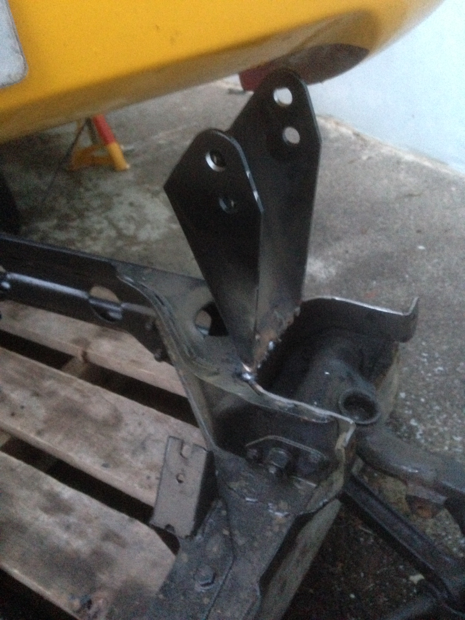

Hi all, well have started converting my subframe to coil-over suspension.
Day 1: chopped off the nearside hydragas sphere mounting and welded in the new top bracket (see pic)
Next job is to add steel to the sides of the upright to give it more strength.
This is prototyping and designing as we go, and now need to check clearance when the frame is offered up. I think the top of the suspension mounting will be well inside the engine bay and should not foul the wheel arch (I hope) !!

Nicely formed top mount - I'd check how much bracing/gusseting you could do inboard of the new top mounts while trial fitting the subframe, so the new mount is able to withstand everything you could possibly throw at it!

Great job mate, where did you get the brackets from?

Post by axshack »
Jin wrote:Great job mate, where did you get the brackets from?
I bought a set of Coil-overs from Huddersfield Spares Ltd (www.minispares-online.co.uk) that came complete with top and bottom brackets.
The top bracket is designed to be bolted to the Mini inner wing, but of course, wont work in the Midas
The bottom brackets have been modified to fit the Metro setup, and of course, the top bracket will take the place of the Hydragas sphere mounting completely.
