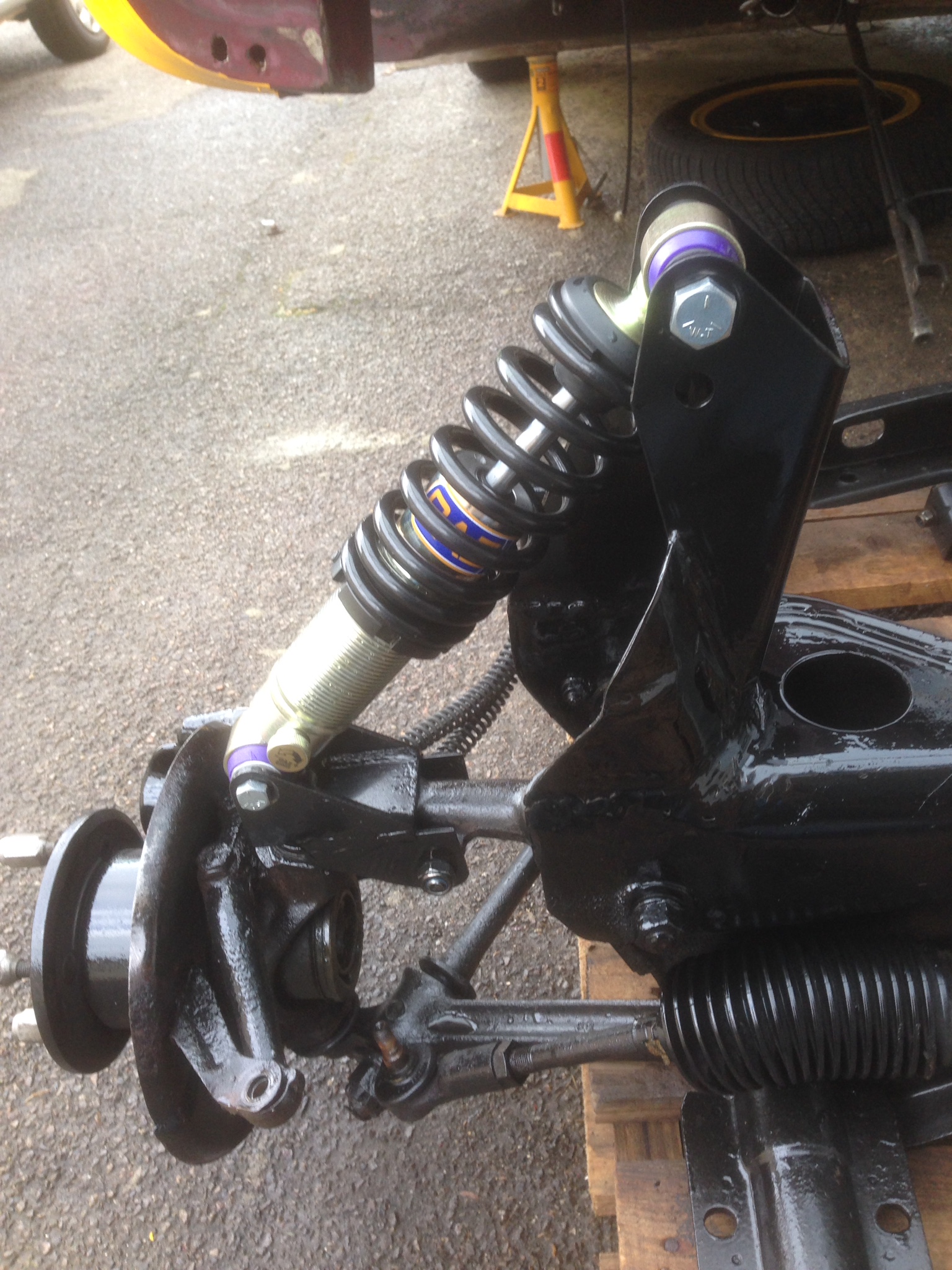

Sub-frame with new suspension parts all painted up and ready for the engine to be installed.

With the bracket for the lower end of the damper being above the top swivel, was there much of a problem getting clearance between it and the wheel rim?
Re: A different Coil-Over solution !
Posted: Wed Mar 09, 2016 10:59 am
by axshack
very good question DavidL, and it worried me for a while as I had not, as yet, fitted the wheels!! but just did so and there is at least 12mm clearance between the bottom of the damper mounting and the wheel rim - phew !! :)

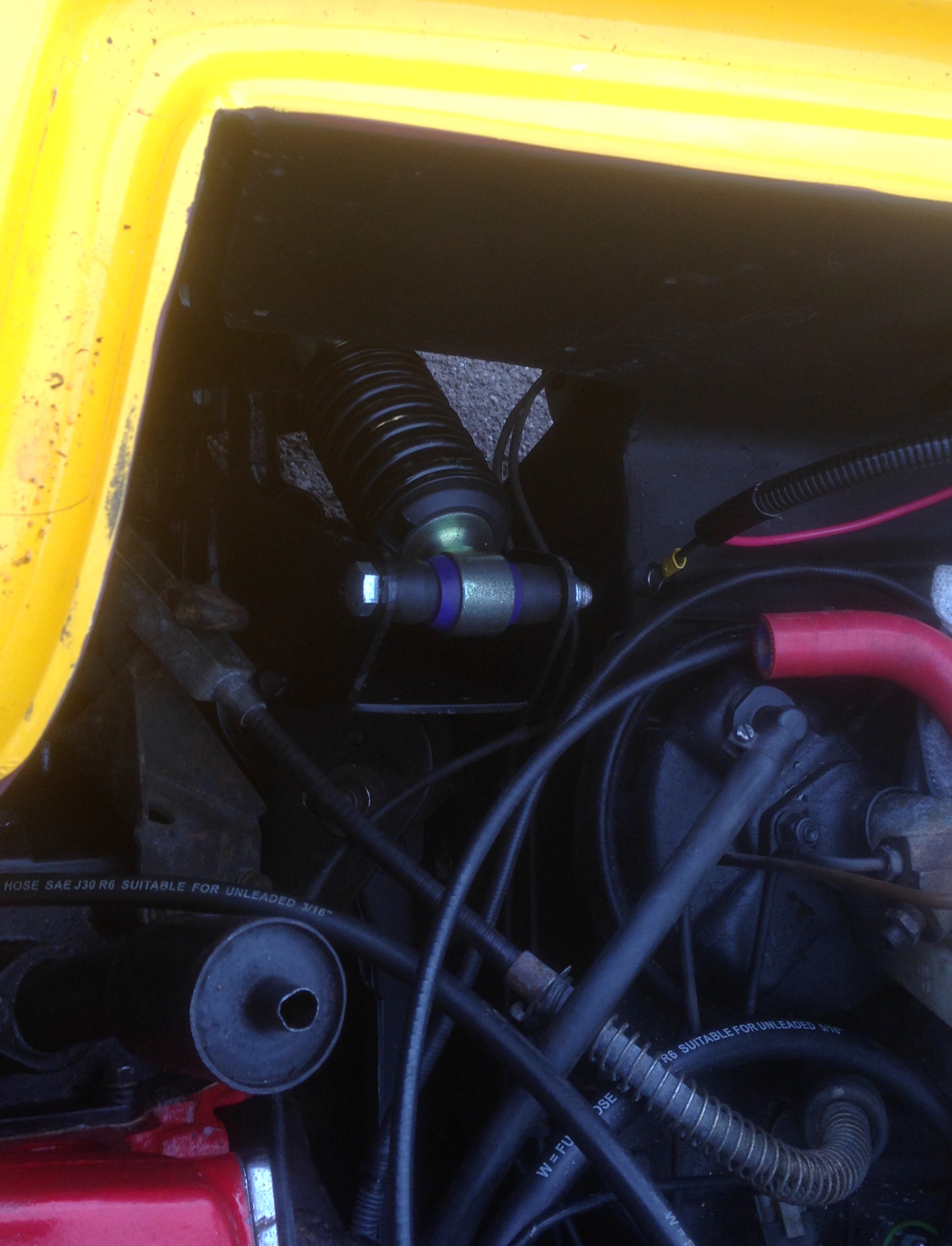

Today, we managed to get the engine onto the subframe and both back in the car...bit of a faff, but we did it.
As I expected the battery box just fouls the top of the new suspension turret on the offside, but on the other side the expansion tank just clears it....magic - but more by luck than judgement if I am honest!
Next weekend will be start up and road test if all goes well !!
see pics below:
