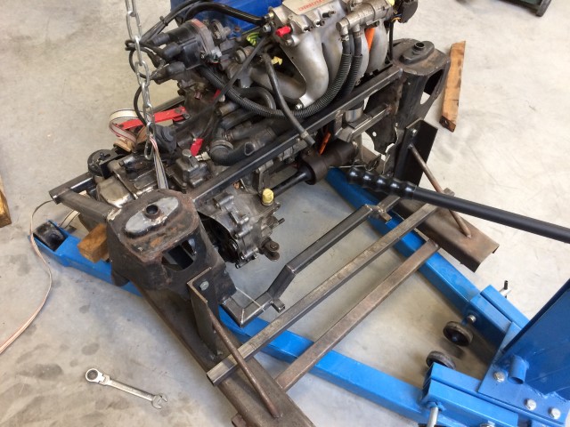

Hi

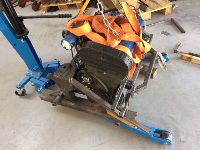

Some news : I do some tests to see if the the engine fits in the subframe .
First tests are positive , the supports must be put in the right angle against the engine , I have seen that the right back support and the front right support are in the same angle, while the front left is about +- 10° less ,something that I did not know ,I will check the angles with a digital protractor to be sure .
Mostly all the screw threads are gone , some one has put to many torque :( , I have order some helicoils to repair the thread .
IMG_1113 (Small).JPG (97.73 KiB) Viewed 23772 times
IMG_1110 (Small).JPG (90.17 KiB) Viewed 23772 times

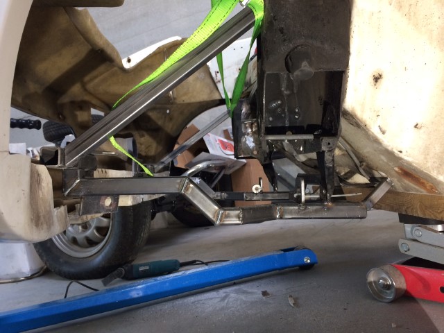

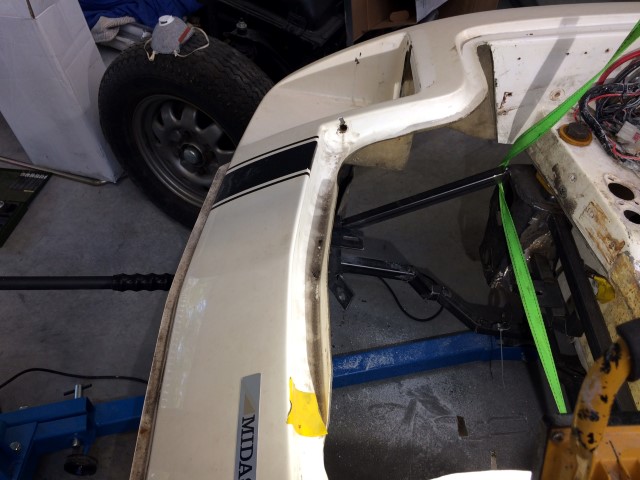

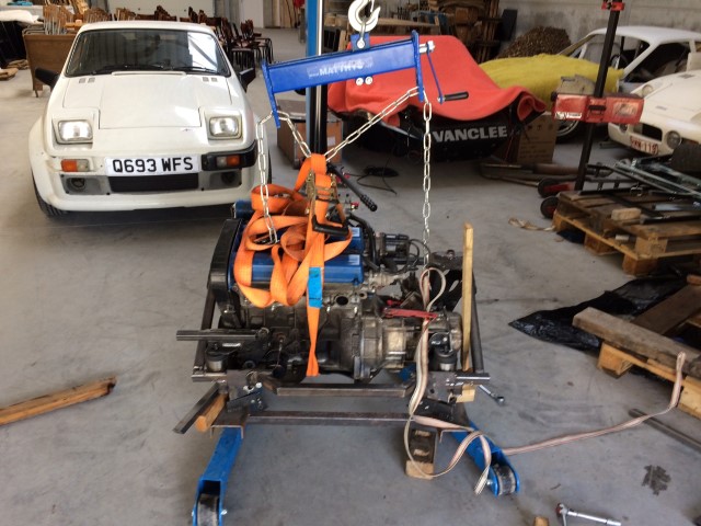

Some pictures with the subframe in the engine area ,I had to cut some pieces of the front underside to pass the subframe
IMG_0174 (Small).JPG (75.79 KiB) Viewed 23772 times
IMG_0166 (Small) (2).JPG (83.63 KiB) Viewed 23772 times
IMG_0170 (Small).JPG (85.73 KiB) Viewed 23772 times

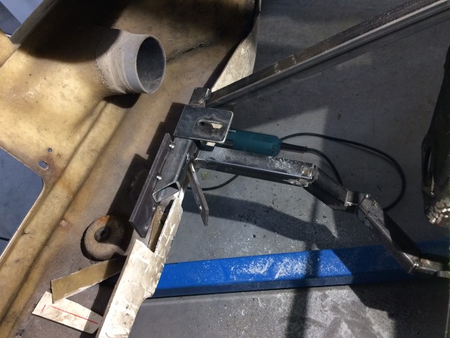

Yes , it's a custom frame using the mini frame but based on the all speed subframe .
Once you have the right position of all parts ,it's not so difficult to make it .
It's my point of view : if you build such a frame you must put the frame on a " holderframe " and see that the towers (left and right) are in the same position as in the car ( vertical , horizontal) and that the distance of the towerbolts are correct ,be aware that the holderframe and the frame you are making are always leveled at 0°,you must capture on the holderframe all important positions of the original frame, then you can start to build up the frame and adapt where necessary, I use a digital protractor for easy and accurate measuring for angles etc.....

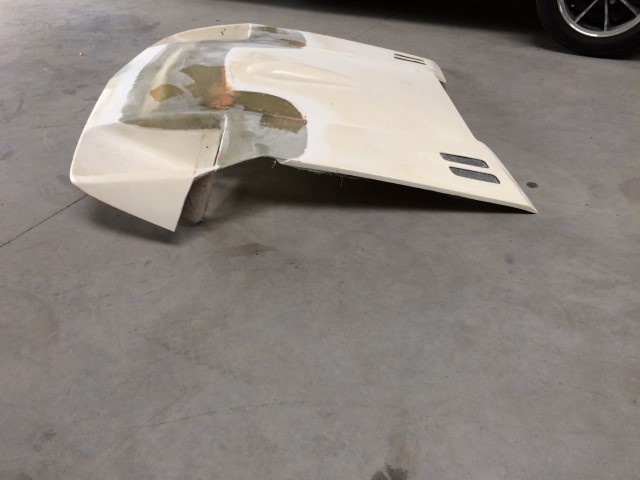

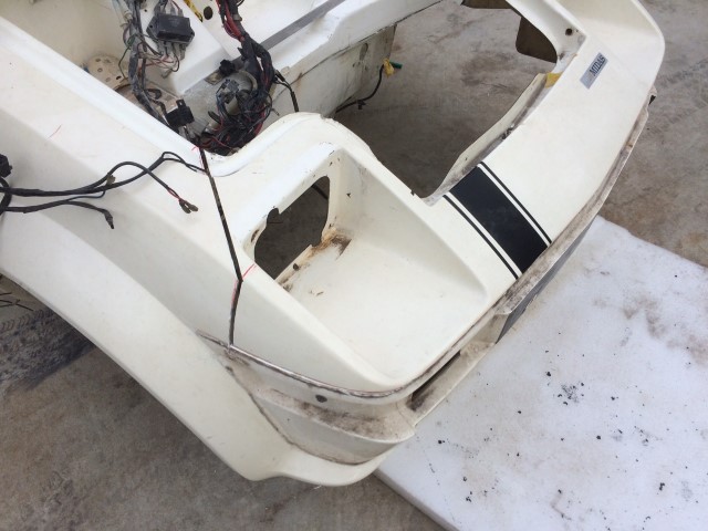

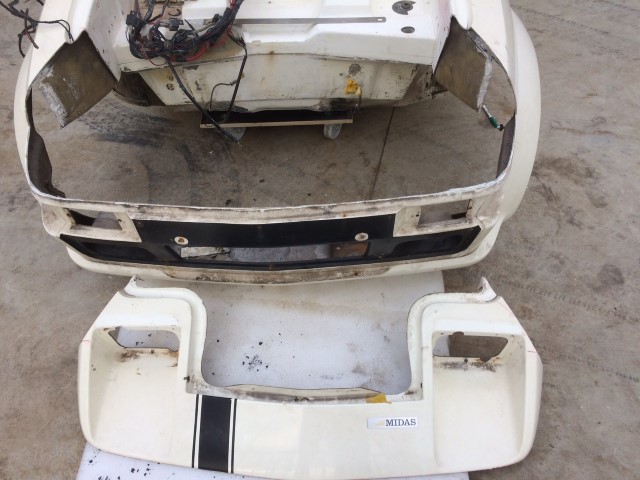

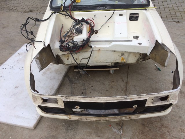

I have started the unknown part of making a movable front !
Thanks to Alan's info , I had the courage to start this modification which will give me finally more space to put the engine and doing later easely repairs/adaptions / etc.....
The bonnet will open over the screen window !
I will laminate the bonnet together when the T° will be at least 12 - 15° C.

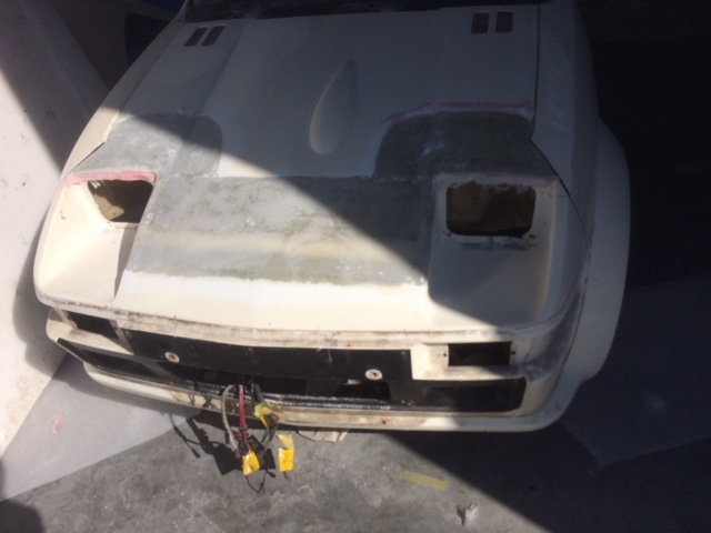

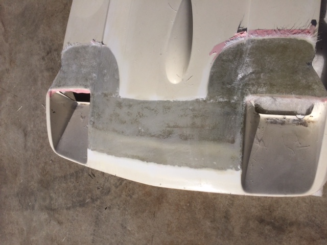

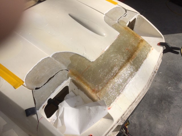

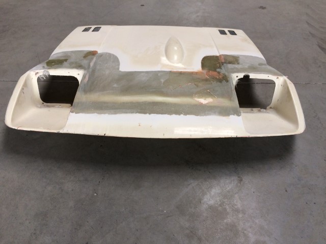

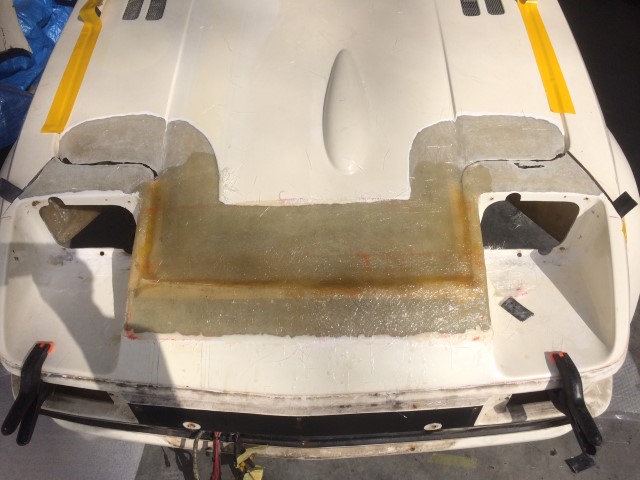

I have started to connect the nose to the bonnet .
It will be a lot of rubbing , lamination , rubbing ......before the bonnet will be smooth , but there's no other way ....I think ?
I started with the upside because you can better see if the two parts are correctly placed , once I have a +- solid connection , I start with the underside of the bonnet which must give the finally strenght of the bonnet .

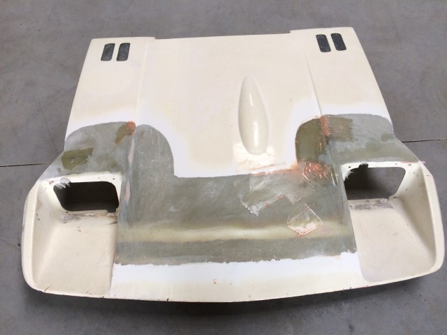

Bonnet is almost finished

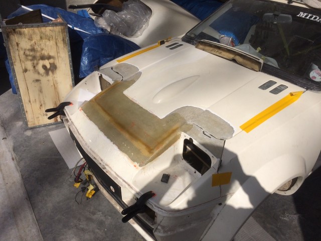

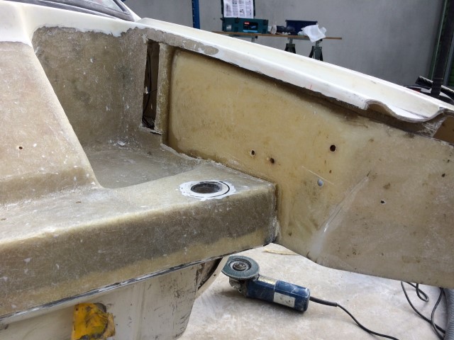

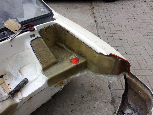

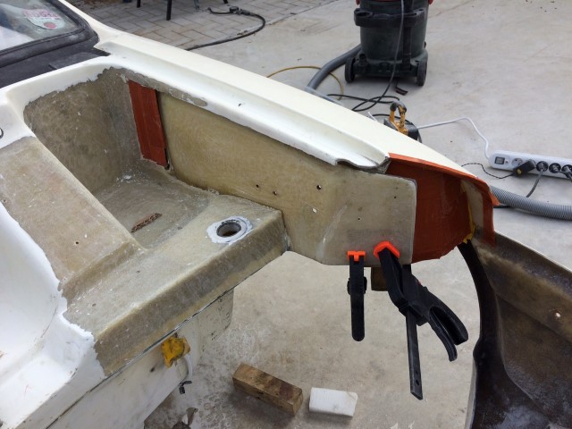

Now I have started to renforce the sides , because I want to make a solid construction which must hold the subframe in the front (teardrops ) .
So I will have 3 fixing points subrame - body :
1) tower / subframe: which stays rather a flexible connection ,even with a 100% solid connectionparts .
2) backside subframe - bulkhead ,which will be a 100% solid connection .
3) frontside (teardrops) depending of the result of the renforcement , I will go for +- solid connection or for a 100% solid connection .
I was surprised that the actual sidewalls were not strong laminated to the bulhead (see pictures ) but maybe more than sufficient enough ?
First rubbing the gelcoat to have a good surface for laminating and than laminate with a first layer of fibre tissue ,afterwards than with some special woven fibre biaxial tissue .
I laminate inside the engine area and outside ( wheelarea)
IMG_1257 (Small).JPG (84.16 KiB) Viewed 23401 times
IMG_1252 (Small).JPG (79.4 KiB) Viewed 23401 times
IMG_1250 (Small).JPG (82.21 KiB) Viewed 23401 times
