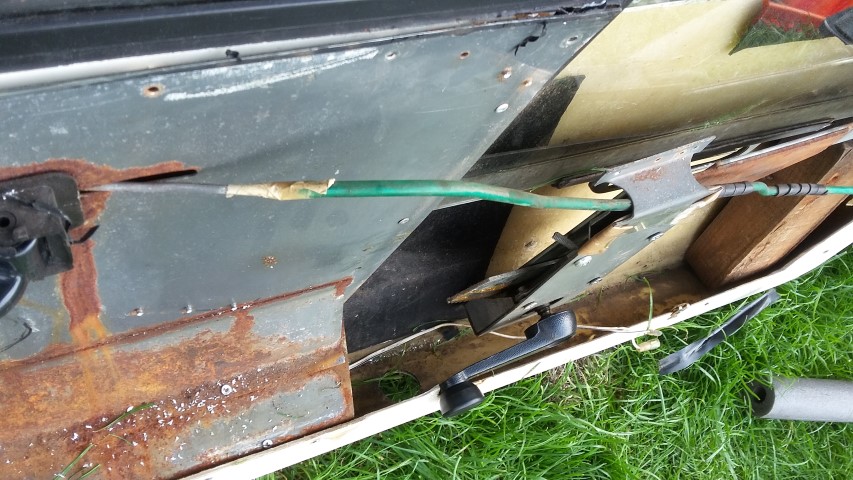

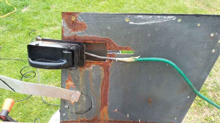

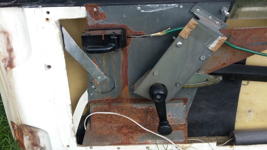

Mechanism of the doors are rusty , the big parts which can be separated easily and will be sandblasted and metallized.
Other parts will be treated with liquid which will resolve the rust and painted with anti rust paint .

Mechanism of the doors are rusty , the big parts which can be separated easily will be sandblasted and metallized.

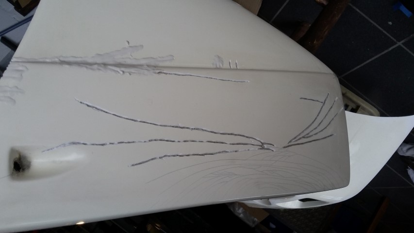

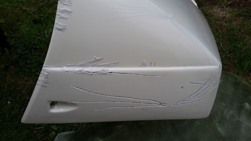

The frontspoiler had some crackings , I milled them out just to the polyester laminate and filled them up with coloured topcoat + hardener , just a little above the spoiler surface .
After one day I sanded this places with 200/400/ 800 grains with good result .
As cracks are coming from an impact or from places where the polyester laminate isn't strong enough ( the laminate can move , but not the gelcoat ) I have laminated the inside of the spoiler with a polyester linen tissue ,this will make the spoiler more stiffer and help to avoid the cracks ( I hope ).
Finally I will put a 2 component -filler -primer to cover all the little holes .

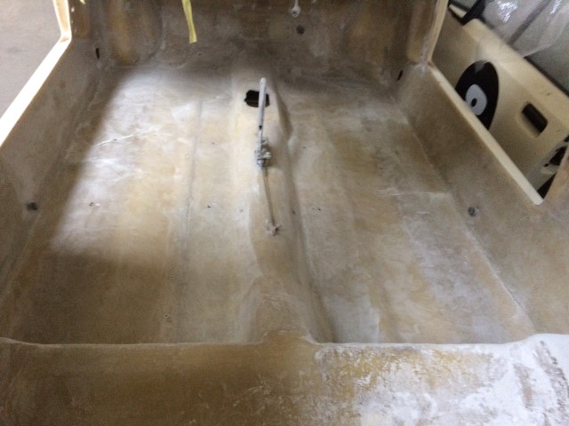

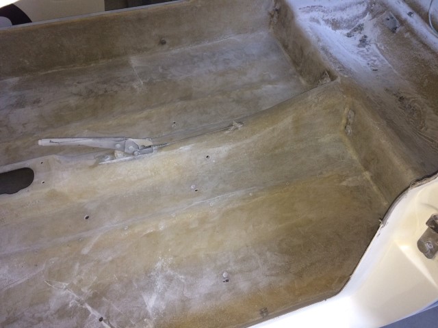

I have all the carpets removed , but there was still a lot of glue on the bottom .
As I want to make a sandwich laminated construction on the floor to make the car stiffer , I had to remove all the glue to get a good contact with the polyester .
Also I will renforce the bottom where the rear mounts of the subframe are connected, to get a much stronger panel .

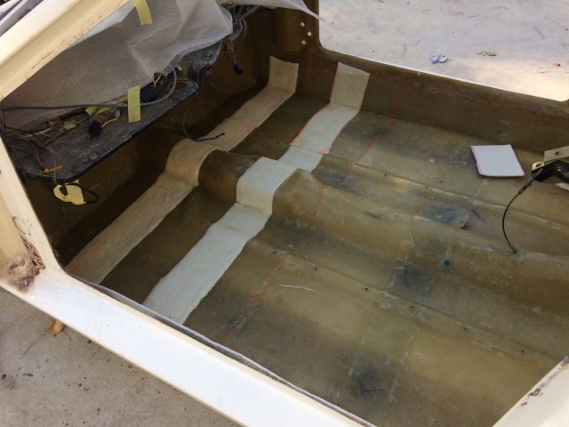

Hi , I started with the lamination of the sandwisch floor , I just put one triaxiale layer all over the floor , then the fillingstrips 12 cm width and 4 mm thick and laminate with a triaxiale layer again .
The next layer comes with the fillingstrip between 2 other fillingstrips , I do this 3 to 4 times alternatively , normally I should get +-20/ 30 mm .
Before I put 3 layers more at the floorarea where the rear mounts of the frontfame are fixed ,this to get more strength of the floor panel .
- IMG_0243 (Small).jpg (68.63 KiB) Viewed 49444 times
That's going to be strong, I'd take a look at the GTM Libra for ideas on additional box sections, I'd also consider a taller rear bulkhead inline with the rear subframe bulkhead for reducing shell twist and improved side impact protection.
edit, forgot to say I'd try to keep the nose the standard length with headlight changes to give space for the cambelt area.
Have you seen Lawson's mods on Facebook to his Micra engined mk2 ?
Hi Stuart,where can I find the Lawson's mods and the GTM box sections ?
Lawson's photos are on the Midas Facebook page https://www.facebook.com/groups/midascarsforum/
Some photos here of the box section in the footwell area http://www.peteronline.co.uk/pages/build_3.htm
