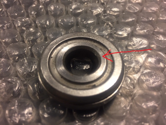

IMG_0362 (1).jpg (97.96 KiB) Viewed 30647 times
Just to let eveybody informed about a point who most people won't pay attention to......
The upperarm must have some play on his shaft ,this play is created intentional by the shaft which is a little longer than the arm .
With this intentional play the shaft can not be jammed after tighted the nuts.
But if the play is to much; the arm will move by braking and accelarating and you will hear a click ,but also the shaft will be hit by the thrustwashers and
the shaft or/and the thrustwashers will wear very quickly !
I had 0.45 mm which was according Mini Spares still fine , but after info of some people, I decided to go for less play.
I machined the border of the big thrustwasher to bring the play between 0.15 and 0.2 mm .
Take attention if there is no play you can jam the shaft and this could be very dangerous !!!!
There is a technical drawing which is not 100% but explains better the problem .
