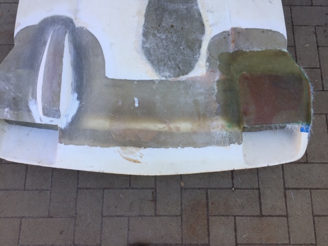

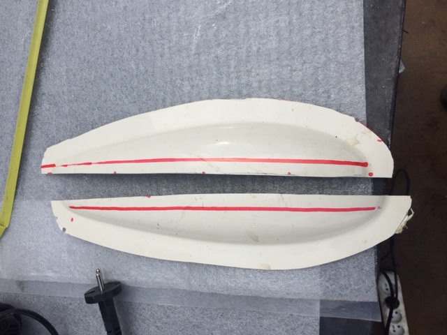

The engine has to be put in a certain position , so the engine can move several cm to the left or the right .
Because of that the hood scoop was to small to let pass the cambelt cover , so I had to cut the scoop and laminate to the exact wide.

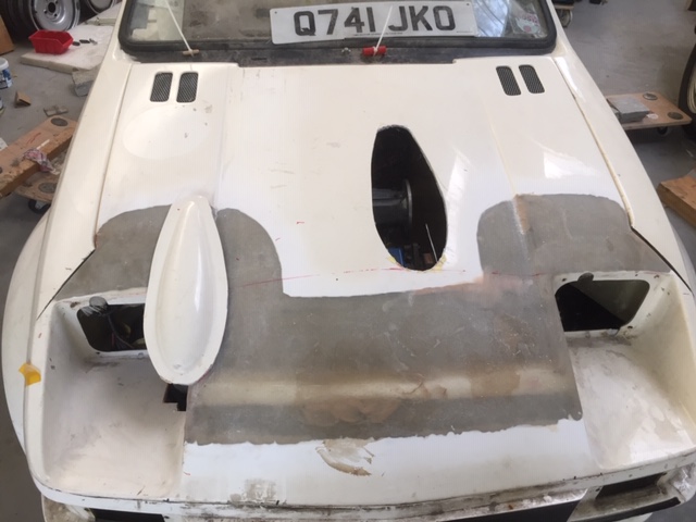

The restauration of my Buggy Vanclee has priority at the moment , but sometimes I have to waite for something and than I work on the Midas .
I did some polyester work for the lights , it's not finished yet but it gives a good idea what it will be .
After the 2 lights comes a backplate
