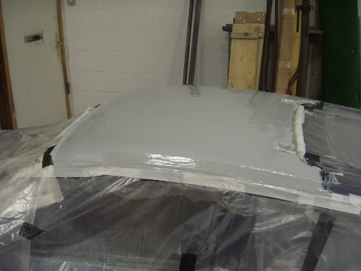

The rest of the car was not as smart, but I still didn't want to cover it with splashes of resin so I masked off the rest of the car with plastic sheeting and then layed up the mould in the traditional way: First the roof got six coats of wax, then I applied two layers of gelcoat - I figured that I would probably be using this mould again - before laminating with six layers of CSM and a section of coremat for extra rigidity.
Gelcoat applied to roof
Gelled roof.jpg (135.31 KiB) Viewed 20618 times

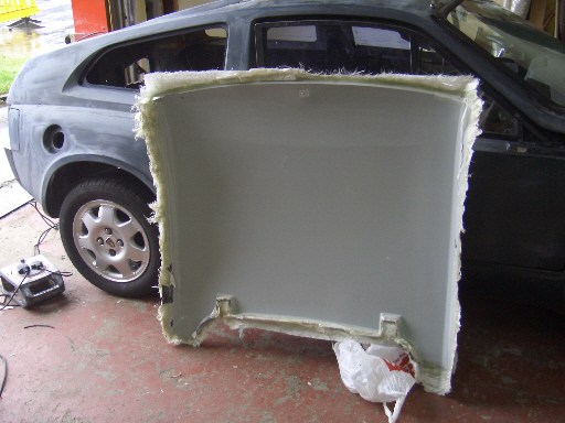

Mould just after lifting - yet to be trimmed.
Mould before trimming.jpg (189.06 KiB) Viewed 20617 times
Once the mould was trimmed and ready for use, it was time to turn our attention to the car itself.

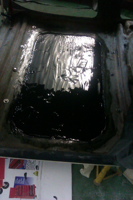

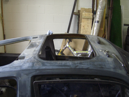

First the old sunroof was removed. Apart from a couple of rusty self tappers, it came away easily enough and left a reasonably clean surface behind. The old sealent came off rather too easily, which is probably why the sun roof frame was rusting.
After removing sunroof

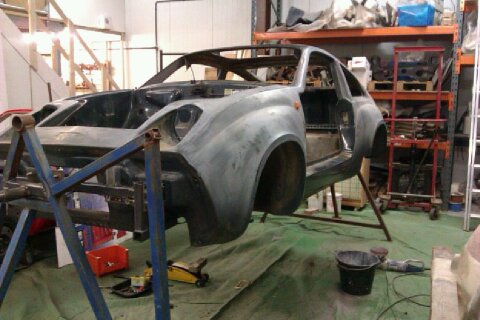

Then the big job of stripping the car down began. The subframes came away quite easily. The engine had been removed by the previous owner, which made the job easier still. With all the panels removed and just a few items of interior trim remaining the shell was ready for the rotisserie:
On the rotisserie, ready for roasting.
Bodyshell on rotisserie.jpg (39.56 KiB) Viewed 20617 times
The rotisserie was made from the A-frames that form the rotisserie for the 2+2 moulds. If the frames are strong enough to support a full set of moulds and a finished Cortez bodyshell, they were going to cope fine with just a bare Gold coupe shell ;) . The attachment frames at each end were purpose made and attached to some of the strongest, thickest parts of the bodyshell (including a pair of front subframe mounts at the very front).
The rotisserie also gave me the chance to give the underside a good clean.

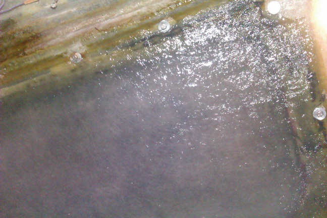

And once the gel had gone hard, but tacky, it was ready for laminating. The first layer of glass matting fitted exactly to the old opening, and then the next overlap by around 1 1/2" to 2" all around. The next layer was another 1 1/2" to 2" larger still and the last layer overlap all around and coved the whole roof area bounded by the reinforcements front and rear - with some holes left to clear the bolts. I didn't really get a very good photo at this stage as the freshly laminated glass matting just looked blurry in the photos taken further back, but a close up of one corner came out clearer:
Close up of newly laminated roof.
Laminated roof.jpg (338.44 KiB) Viewed 20617 times

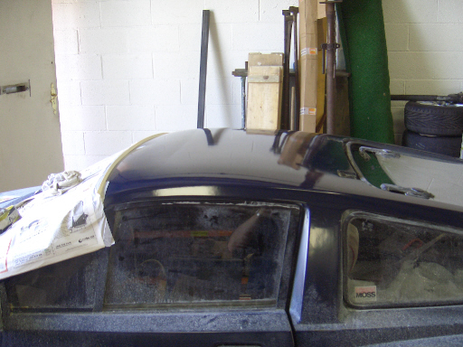

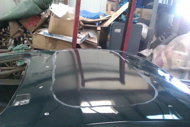

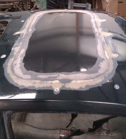

The next step is indeed to laminate some strips of glass CSM over the top of the join. The new section may have got a good bond, but only from one side. I wanted to be sure that the roof was as strong as, if not stronger than the original, so I had to take the angle grinder to the top surface and created a tapered area around 3 inches wide either side of the join line to allow additional glass to be laminated on top.
Roof join ground back in preparation for laminating in additional CSM strips
Roof ground back again.jpg (215.68 KiB) Viewed 20616 times
To achieve a good smooth taper, I start with a flexible grinding disc in the angle grinder, probably P80 grit. Once I have roughed out the taper I smooth it off using P120 production paper on my trusty old 3M body file. It is important to achieve a smoothly blended edge to the old gelcoat so that the new filler blends into it gently. Otherwise sudden changes between gelcoat and filler can show through the paint as shadows.
The sharp eyed will have noticed that I also tapered back around the bolt holes. These were filled from both sides with bridging filler (glass loaded polyester, such as Isopon P40).
Two layers of CSM strips were then laminated across the join, starting with one layer about 4inch wide and then a layer at 6 inch wide. Once that had set hard it was time to apply the filler.
I prefer to use aluminium powder filled bodyfiller, such as Metalik or Chemical metal. My preference is based on experience gained over the years and is probably a bit of overkill for a GRP body. Most bodyfillers, such as P38 and Easy Sand use talcum powder as the filler agent. It is cheap and makes sanding easy. However, it is hydrophillic, i.e. it attracts and holds water. This is why repairs on steel panels with talc based bodyfiller can rust through and start to lift. On GRP panels if the talc based filler isn't sealed properly it will take in moisture and expand leading to ripples and bumps. Having said that, part of our paint process is a layer of epoxy undercoat which is strong, flexible and pretty impervious to water, petrol etc. So maybe my expensive taste in bodyfiller is just overkill.
The filler stage is where the efforts of making a good mould and getting it fitting tightly to the roof really paid off. Having the new roof section perfectly aligned to the old roof section minimised the amount of filler required and the amount of flatting back with the bodyfile. Not only does that make it easier work it makes for a better job all round.
