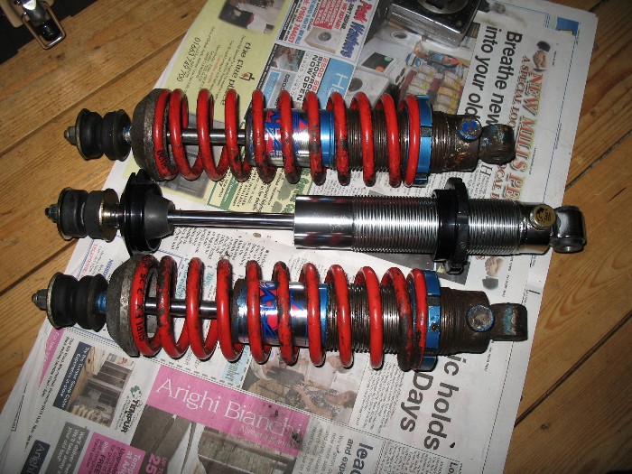

I've had AVO's and in all honesty they were comparable with Spax and GAZ. I imagine the production techniques and paints used have also changed over the years too.
GAZ do a shiny zinc finish, but that still rusts. Pro-tech are well rated these days, with an alloy body, but I'm not certain if they're anodised.
Here's some of my shortened AVO's next to a standard length GAZ. I've not actually driven on the GAZ dampers so can't really comment. I know Alan hasn't had much success with getting a nice ride with his GAZ set-up and they've gone rusty despite the zinc finish.
