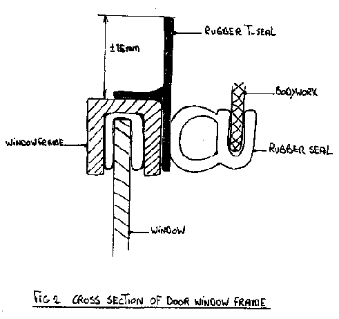

That's a subject I have written about on my website. You can find info about it on the technical page on midascars.net. There's more than just the doorseal to make your Midas weatherproof. To start with, glue a T-seal on the doorframe:
It will close the gap between the doorframe and the monocoque. works perfect.

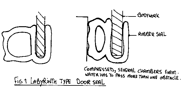

First start with the rubber seals. Modern cars have 2 seals, one on the door and one on the bodywork. The Midas has only one which is an old-fashioned seal as well. The round shape of the seal makes it quite easy for rain to follow its curve and seep through, wetting your seat. So I changed it for a sort of labyrinth type, see fig. 1. The seal has 2 extra edges. Water following the curve of the seal will stop at the first edge and follow its path linear to the seal downwards.
But this won't be 100% effective. So I bonded a T-seal on the window frame as indicated in fig. 2. When the door is closed, it fills the gap between the window frame and the bodywork. Heavy winds will now have a positive effect because this T-seal is pushed against the other bodywork seal and rain can't come in.

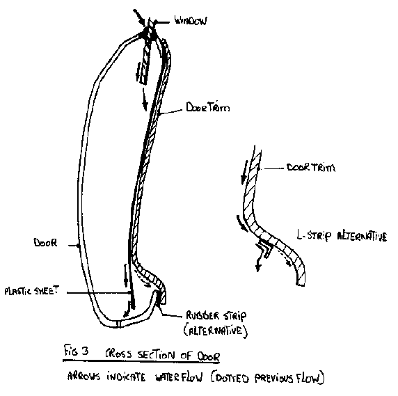

Luckily one day I was working in my car when it started raining. I had removed the door trims and saw that rain ran between the window and the window-seal into the door. When the door trims would have been in place, the water would have dripped on and followed its curve.
Since the door trims must be placed INSIDE the bodywork seals, water will drip on the seal and run into the car. This can easily be solved by glueing a plastic sheet in the door. Make sure the lower edge of the plastic hangs in the door, see fig. 3 (check that the rain holes in the door aren't clogged). Fold the plastic upwards at the metal plate that holds the window mechanism, don’t cut the plastic. Another option is to bond a thin rubber strip on the door trim, so it can be watertight fitted to the door. Also an idea is to glue a small L-shaped strip at the lowest corner of the door trim to separate the waterflow. I haven’t tried this one.

Concerning the door, in case of large quantities of water I would say the internal waterstream is the biggest culprit. so it's best to make sure the door can drain the water by 1 or 2 holes in the bottom and a plastic flap inside will guide the water to the bottom and prevent it running into the interior. Easy checked, just sit inside the car during heavy rain.

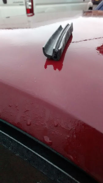

Not sure if Alistair has some I expect he has but I bought a slightly different profile at the recent Classic Car and Restoration Show at the Bath and West Showground. I could have bought the same profile but after a fair bit of contemplation I bought a profile that is basically a U shaped channel on the same Tight-n-Fast trim. I'll try and find out what the profile numbers are for each and who it was that I bought it from. They are always at the shows but Alistair knows the profiles and has seen mine.
I think the U shaped channel works better as the water runs into it and then away from the car where the seals are vertical in the door jams. So far it's proved to work 100% and we've had a fair bit of rain though I've not driven the car very much of late.

It's a generic type o-seal, not related to any car or model. But it's not the most important mod. You can buy any type o-seal, just make sure the grip is wide enough for the thick GRP wall (may o-seals are designed for thin steel sheet edges) and the diameter of the "O" is big enough. The labyrinth just adds an extra bit of dryiness. To get your car really dry, fit the T-seal on top of the frame and the inner plastic sheet inside the doors. With these mods your doors will stay bone dry.

Can't find the paperwork for it but this is a photo of an offcut
Rubber drip channel
Rubber drip channel
