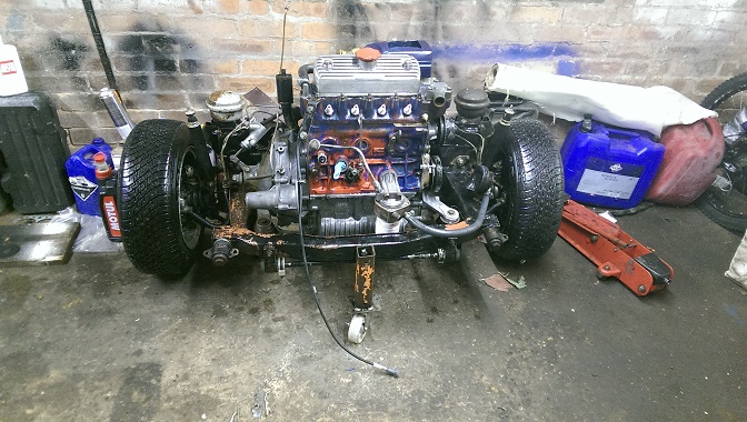

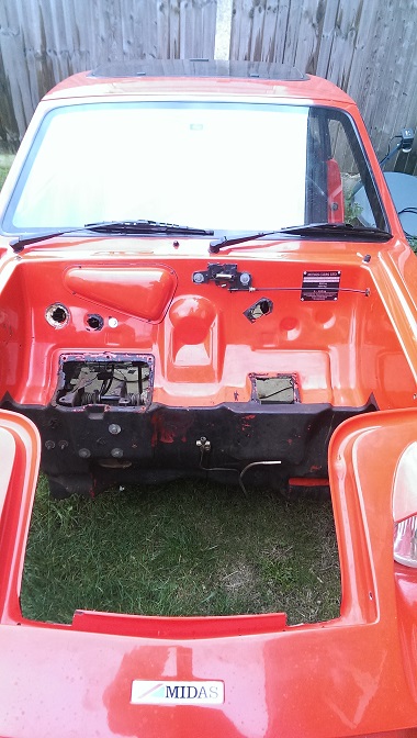

]Over the past couple of evening I have found a couple of hours to carry on stripping the car. The Interior is almost entirely removed, the wiring is out and some of the new back in and today I removed the front subframe/engine assembly, alone, foolishly, as a midas is not really a one man lift, however it was getting dark and my helper had not arrived. I have also this evening added a castor on a piece of box section to stop the engine/subframe toppling over, works wonderfully I'd recommend it to anyone who may be planning on removing the subframe and engine together.
- Engine as removed.jpg (139.86 KiB) Viewed 40531 times

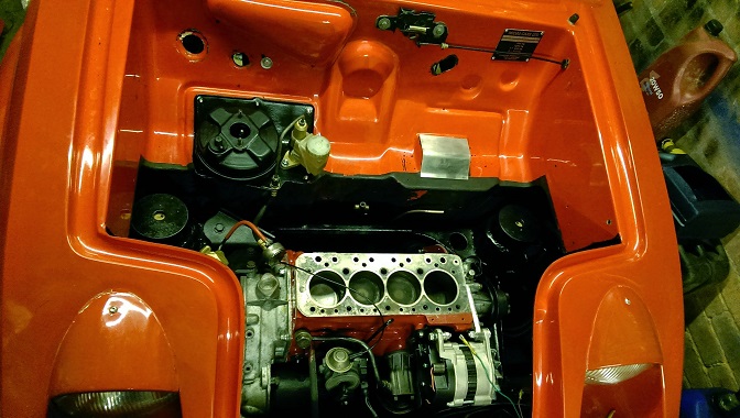

- baron engine bay
- Empty engine Bay.jpg (115.47 KiB) Viewed 40531 times
- As car stands
- Front subframe removed.jpg (154.1 KiB) Viewed 40531 times

Additional castor
As in the previous post, photo showing the castor added to stop things falling over.
- Castor on subframe
- removed engine washed.jpg (144.28 KiB) Viewed 40531 times

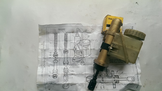

Clutch master cylinder
Todays little job, clutch master cylinder. Stripped, cleaned, sanded, primed and painted then re-assembled with a rebuild kit.
- Clutch rebuilt
- Clutch master rebuilt.jpg (116.03 KiB) Viewed 40532 times
- Clutch rebuild kit
- Clutch master kit.jpg (143.32 KiB) Viewed 40532 times

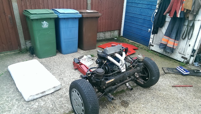

I haven't updated for a while so here goes. The car has been stripped of the front subframe, engine, exhaust, all wiring, interior and metro heater unit. The subframe has been altered to take the mini coil springs as both hydro units looked in questionable order. the subframe and engine (albeit without a head at present) are both back in the car. the engine has had the gearbox replaced for one with a taller final drive (3.105 from 3.44) and a centre oil pick-up pipe. The cam has been replaced with a Minispares evo item along with duplex timing gears and a new oil pump. The head has had the ports cleaned up and opened out a little and has had a little skim to ensure it is flat. Single HIF44 carb has been altered according to the Vizard books. The rebuilt clutch master cylinder is refitted, the brake master cylinder was replaced previously so it has just had a clean up and lick of paint. The car came with a new radiator so I have fitted that along with a new slimline fan. The seemingly endless task of wiring has begun, I have been trying to conceal as much of the wiring as I can to leave a tidy engine bay. As for the interior I have seats and Clocks that I want to use and a centre console is under way but I am still undecided on what material to use for my dash and the centre console front, I am torn between Aluminium, burr walnut and vinyl, time and availability will tell.
- Under Bonnet.jpg (119.26 KiB) Viewed 40534 times

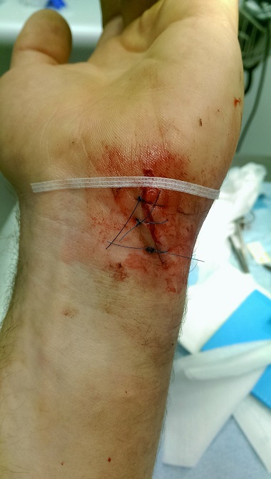

Tuesday 23rd, Exhaust system to fabricate, car jacked up high and put on stands, make a start, slip over in garage, hand/arm cut needing stitches and i'm home alone with the car on the stands and blood everywhere, needless to say this has hampered my progress.

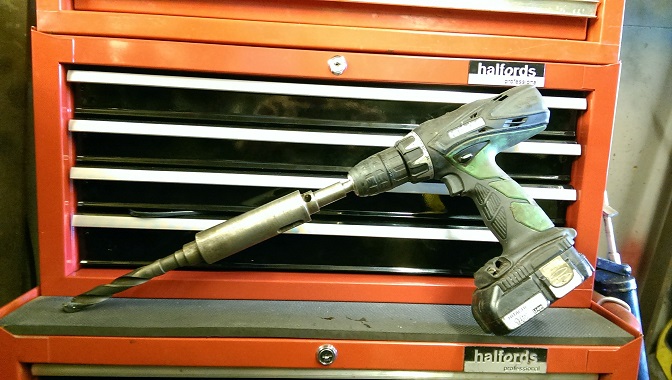

29th. Need to look at the sump, its f*@cked. Dont want to take the engine out so time to fire up the lathe. The threads in the sump where stripped entirely so I drained the oil and drilled out the sump plug hole (in situ) to 17.5mm with a massive drill extension/morse taper adaptor to allow me to tap an M20 thread. Then I made a hollow sleeve that was M20 on the outside with a 30mm collar and M16 on the inside so I could use an M16 bolt as a sump plug. The whole thing was screwed into the gearbox with a liberal coating of hysol e-metal to secure it, so far doesn't leak. I will take a pic once I am convinced it has worked.
