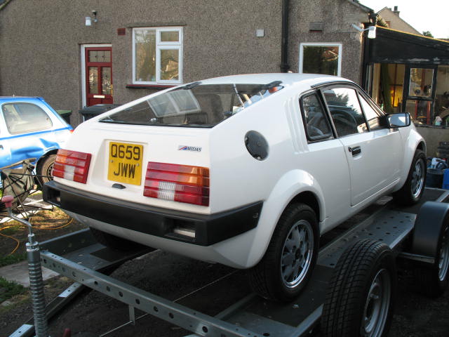

I was thinking about improving on the standard metro rear lights to use modern LED units and then came across this Belgian car the owner of which has done exactly what I had in mind ! Anyone know this car or the person who built these units....I would dearly like to get hold of the moulds and make a pair for myself (if they exist that is). Just trying to save many hours of fabrication if I can !!

I know the Dutchman who built it. His name is Joris Droste.Later he sold his car to Belgium. I wrote about this project in 1 of the club magazines I edited. It is a scratchbuilt project and there are no moulds.He made it from wood and he removed the lights from Subaru aftermarket clusters.
Another project was by Charlie Dodd.he did produce parts from a mould in which caravan lights were mounted. There are pics of a dutch green coupe on internet with these lights. Another option are the Brazilian Cavalier cluster lights. A Dutch red convertible have these.They are from clear plastic.

Here's the text I got from Joris:
My beautiful Midas needed a change at the back. The Ascona/Cavalier taillights annoyed me from the beginning. In a tuning magazine I saw a Subaru Impreza with after-market LED taillights. These were the lights I wanted for my Midas. They look like Lotus Elise (I'd love to own one of those!) taillights because of the clear center with a red edge. Funny that with the latest update they were changed to a LED style as well. Have the Lotus chaps seen my Midas driving by?
After some research I found the taillights for 299,- euros (about 200 GBP). A bit expensive for lights I was going to saw in pieces with the chance it wouldn't fit. After many evenings surfing on the internet I located the manufacturer. I mailed them with the question if I could buy the lights without the Impreza plugs. It was possible and for 140,- euros (about 100GBP) they were sent to me.
When I received the package it turned out that they had sent the complete Subaru units. So I still had to cut them loose. After having taken measurements the saw went in and I ended up with 8 pieces, 4 reflectors and 4 lights. Now it became clear if they would fit!
Quickly I discover the existing apertures in the body are too small. I need to widen the holes in order to fit the lights side by side.
Another problem is how I must build the plugs. Many attempts lead to nothing. After almost half a year of fiddling I decide to build the plugs from plywood with an epoxy coating. The same way boats are made. For me as a carpenter working with plywood is a piece of cake. The curves are made by bending an aluminum plate. When everything fits, I smooth it out with epoxy. I have no experience with this stuff, but it's quite easy. Mix the 2 components in the right order and brush it on. It flows out mirror smooth. After 4 coats (let it cure thoroughly in between) I am satisfied. Just a matter of using filler for a few small dents and sand it down. As the original Subary lights I spray the plugs in high gloss black. The apertures in the Mias are widened and the lights are installed.
Unfortunately there is quite a bit of rain leakage, but it's solved by installing several types of rubber strip. Then it's a matter of hooking up the wiring and finished!
I am very pleased with the end result. And I've got rid of the Ascona/Cavalier taillights that everyone recognized at first glance. In the mean time my Midas has passed the MOT with the new lights, so no problems with legal issues.

Hans, many thanks for this info....I was going to sacrifice the current lenses and use them to make moulds. I think I will still do that in due course.
Eventually, I will use LED lamps from www.cbsonline.co.uk.
This is going to be next year's activity, as I am concentrating on vinyl wrap, powder coating wheels and fitting MX5 seats at the moment!
