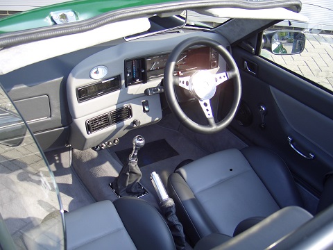

That can be harder than it sounds as the carpet will account for one colour and often the seat another. One of the best finished cars that I have been involved with is Stephen Kennedy's Gold Convertible.
He chose two shades of grey for the interior with the darker one on top (less reflective), so a light grey carpet was chosen to match the lighter trim colour.
This was the first Midas Gold with the IVA compliant door frame and my new door cards. The one thing I hated from my Excelsior was my elbow banging on the door release, so I moved it up and forward to alongside the steering wheel, to right below the point where the little steel triangle shows above the door top. This point provides three locations to tack weld screws to to hold the door pull in place. I also upgraded the cheap looking Metro door pull for a Rover 200/400/600 plated door pull. The pull rod just needed to be extended with some welding rod.

That looks great, very high quality.

I think they were off the earlier (square back) Rover 200, but also found in the 400, 600 and 800 and yes they were basically a direct swap. The fitting for the rod end is identical, but the plastic moulding is designed to go on an edge. I designed the new door panels to be in two parts, with the door handle recessed into the bottom edge of the top section. It is a shame that you missed the open day as you could have seen Stephen's car for yourself.

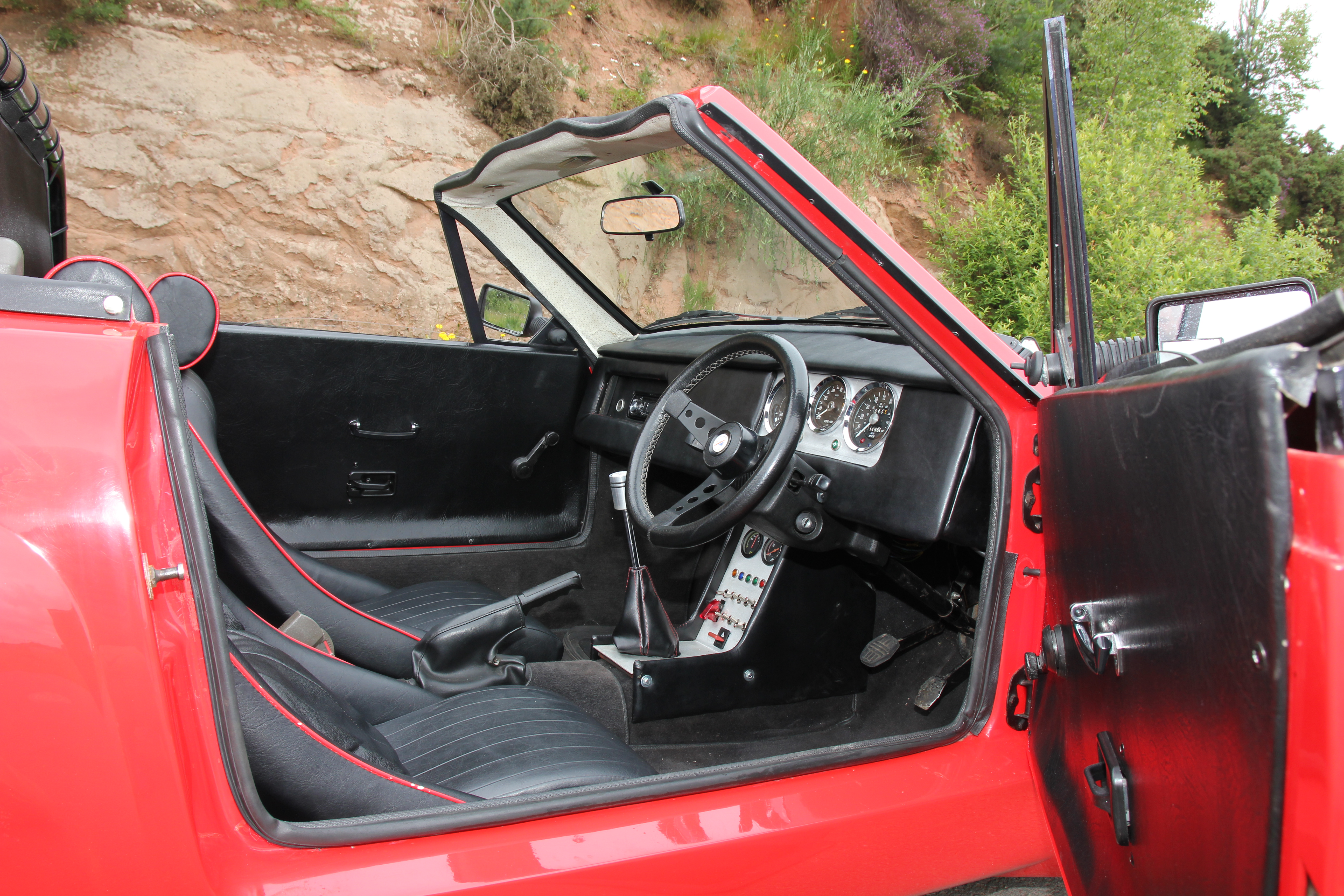

My interior is black with red stitching and piping, I have aluminium clock surrounds and centre console to brighten it up, black and red are good choices though.
- Interior
- Interior.JPG (6.85 MiB) Viewed 61756 times
