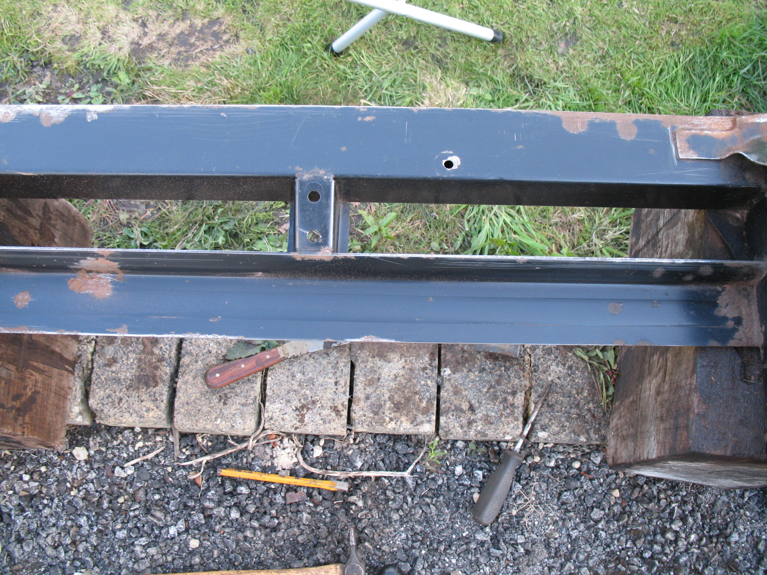

Midas cars had a new hole drilled into the subframe for the handbrake guide cable to the nearside and then used a special short handbrake cable
Picture 9.JPG (99.85 KiB) Viewed 21016 times

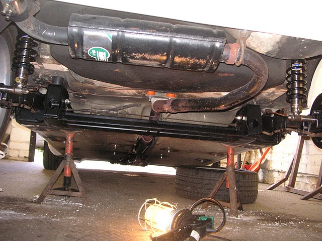

I think a standard cable will work with a single neat coil in the cable.
That looks just right to accommodate the corresponding Metro handbrake cable. Also allowing the handbrake lever to be moved backwards, in turn allowing the repositioning of the gear lever back a bit too.

I must remember to make provision for something better than cable ties to hold the handbrake cable in place on the radius arms.
Of note is the weight of the handbrake cable compared to the Mini arrangement.
