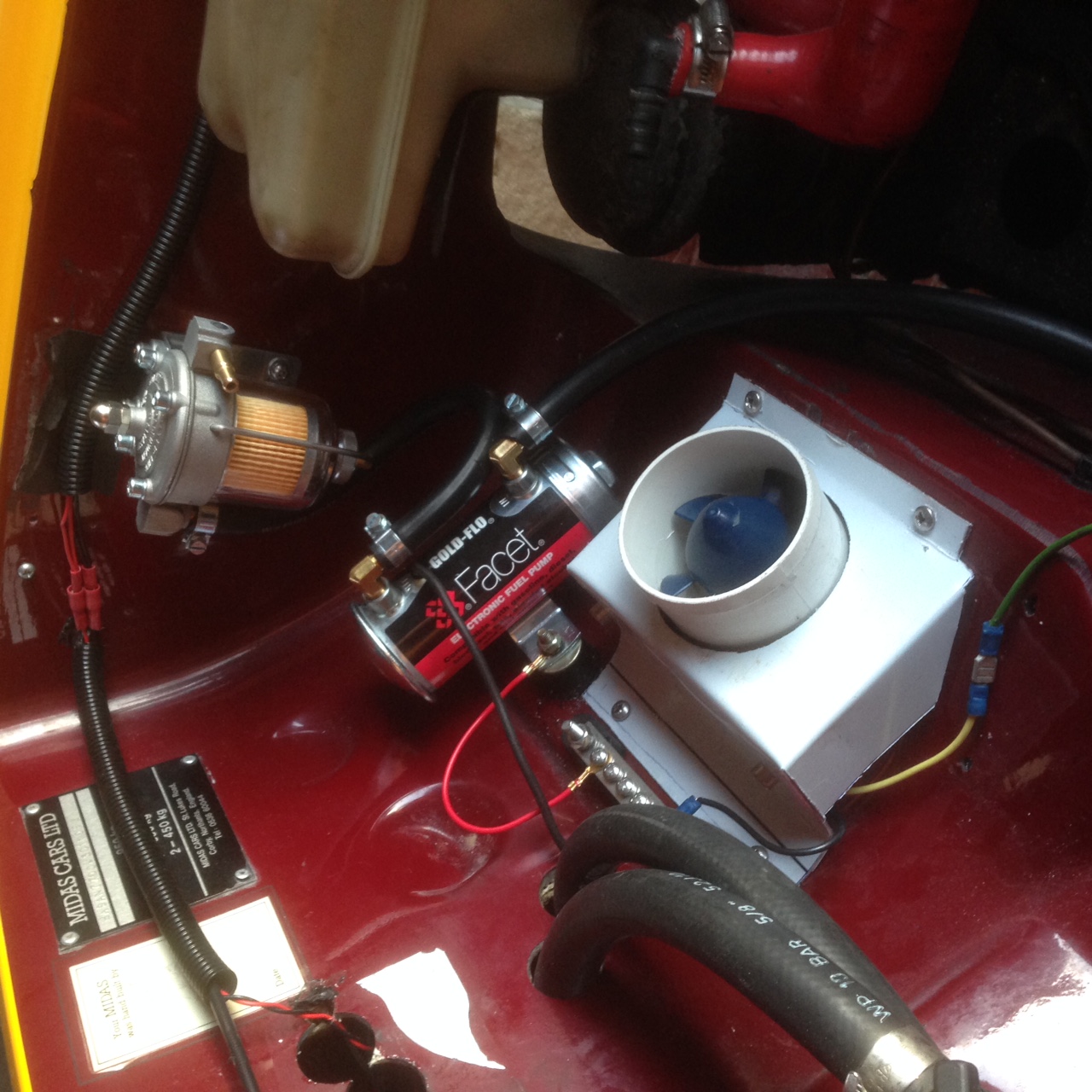

In order to make room for the new fuelling arrangement, I have removed the almost redundant Metro fresh air intake as it takes up a huge amount of space, and replaced it with a coaxial fan designed for boats as a bilge extractor - it moves a lot of air for such a small unit.
2 photos attached showing it - and the interface plate I made up - in position, along with the new fuel pump and pressure regulator. I will be finishing off the fan housing with a covering of glass fibre woven cloth to seal it into the hole and to make it look better.
for some reason the photo is flipped when uploaded....bloody thing :evil:

Looks nice that. Good job with the fan.

manifold wrote:Looks nice that. Good job with the fan.
thanks...took a bit of faffing about, but got there in the end !
