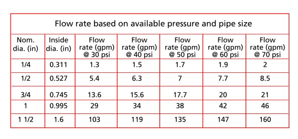

Post by streetsy »
What size line runs from your tank? If you double the pipe diameter the flow increases more than four times for the same pressure.
Flow and diameter
Flow and diameter
