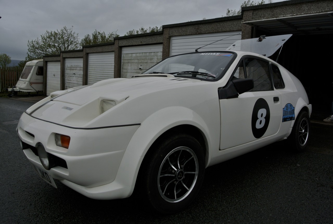

Re: Tyre sizes
Tony put 14" wheels on, but modded the hubs to 100 mm PCD
Also a very brief search doesn't come up with many suitable tyres. Perhaps 15's like Jin has on his MK4 will give more tyre choices :?
