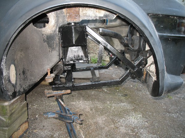

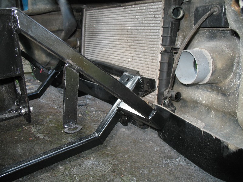

- IMG_0177.jpg (161.5 KiB) Viewed 20445 times
- IMG_0175.jpg (120.05 KiB) Viewed 20445 times

Yes that's an Allspeed Vauxhall C16 frame in a Midas MK2. I've known Rob for over 20 years, he's a nice decent man. I imagine he'll remember the issues I experienced with the Midas.ilmung wrote:Hi Stuart

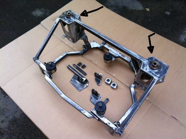

It's these top corners that hit the shell.

If you place the rubber cone inside the tower and you look how much clearence you have between the cone and the wall ( at the inside of the tower) maybe
than I can adapt/ reduce the corner of the tower at that place , seems this action correct to you ?
The part I should take away ....is that a big part ...can you give me an idea ?

It's only millimetres, perhaps best to try the frame in the shell first to see. If I get chance I'll try and get a photo of the inside of my wheel-arch where I ground it for clearance.

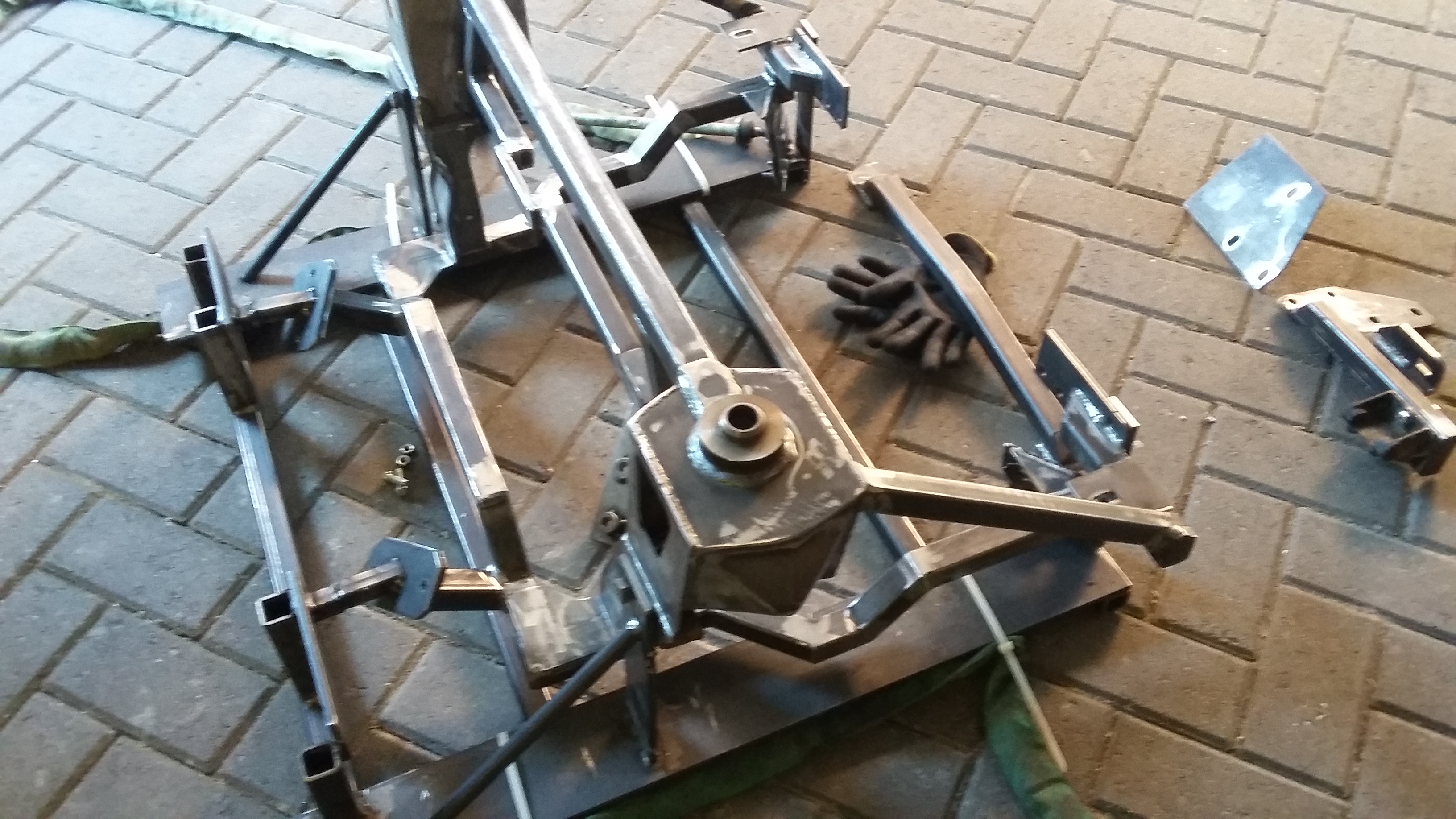

Wonder never cease :a total unkwown and very kindly person explained me how to build the subframe for the suzuki gti conversion / Midas MKII
He even gives me his mould and an adapted Allspeedsubframe for a mini classic conversion , I can hold the mould for +- 8 weeks ,this must go !
I will use the mini classic towers and build around the tubes for the engine fixingpoints ,etc.....
So I can build the subframe by myself now .
like Stuart mentionned already , I have just to adapt :
1° the rear lower subframe legs to the body
2° the front mounts to the body .
It do not underrate the job ,but with the help of the Midas forum members ,I expect to finish before the summerholydays 2017 .
