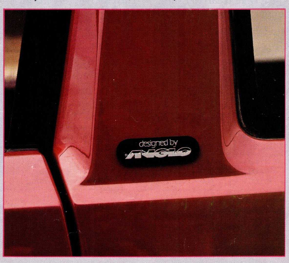

I see you have one Anglo badge, my last mk3 had those, but not my current mk3.
designed by anglo.JPG (141.17 KiB) Viewed 49452 times
Re: MK3 Coupe project. The wifes fault, really, it was.
I've never seen one of those before. Who they?
Geoff Butcher wrote:I've never seen one of those before. Who they?
Richard Oakes. My understanding is that the first so many mk3's were required to have the badges as a sort of royalty. Happy to be corrected if that's incorrect though.

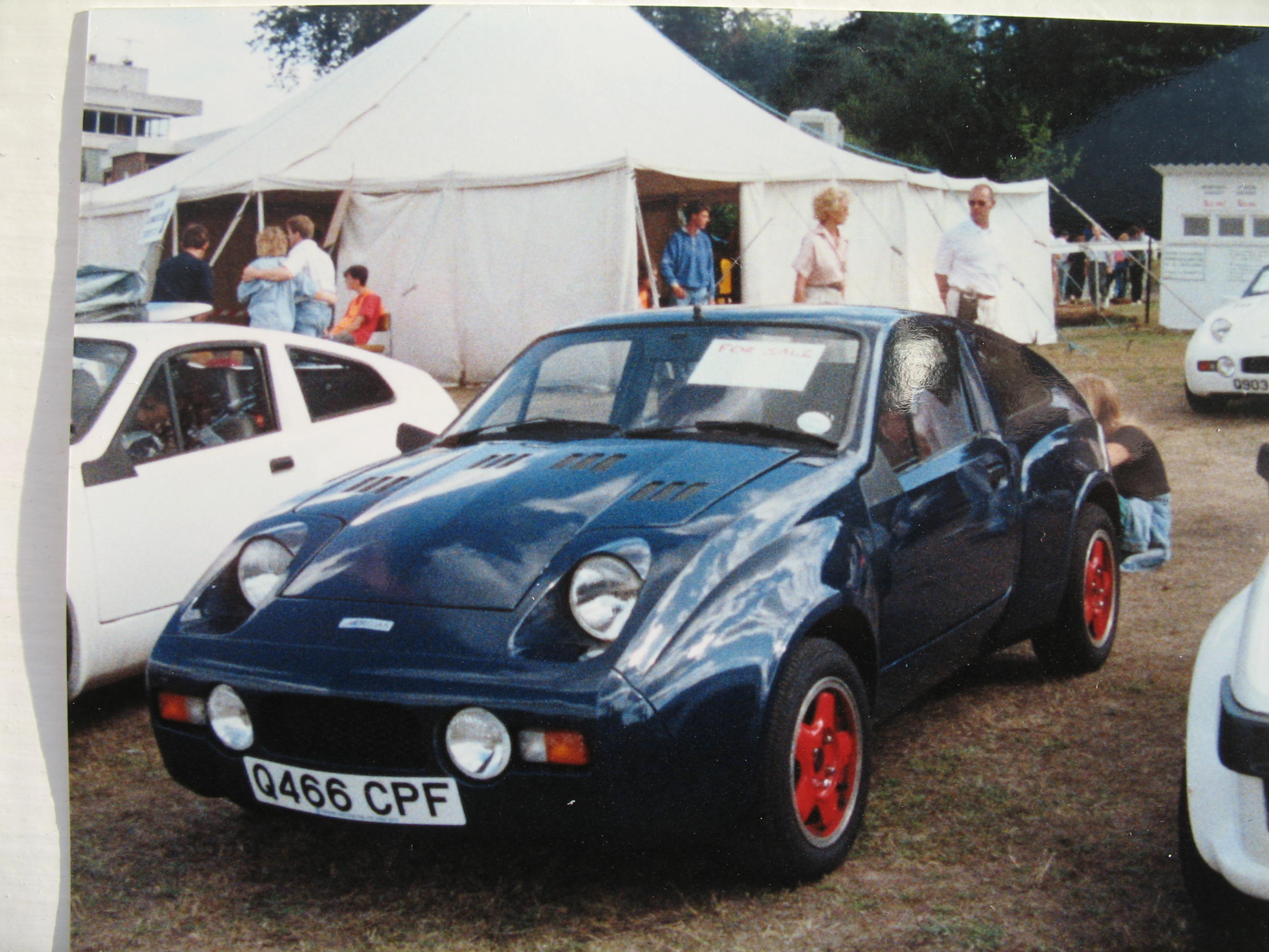

Looking on the bright side for the car the gel coat under the bonnet and on the floor should shine just like this
mk3 Sandown.jpg (548.84 KiB) Viewed 49448 times

Stuart wrote:I see you have one Anglo badge, my last mk3 had those, but not my current mk3.
Well spotted Stuart, I often wondered why only a certain number of MK3s had Anglo badges fitted, and as you have mentioned I'm afraid I've only the one. :(
