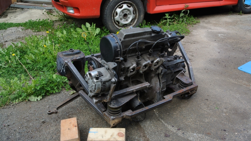

Stuart, picture will follow, the car is MOT'ed , so just trying to get back on the road. It seems to have an excellent engine and mechanics, the gearbox is out of the Cubman GT, with a higher 1st gear and a close ratio 2nd & 3rd, with a 3.7 diff. But the body needs refurbished, it got a few stress cracks and the usual faded red paintwork. I just wonder why it has done so few miles in its 37 years (27000). I have only driven it on to the trailer. I'm guessing it's noisy and uncomfortable.
I think the sun roof has been leaking and destroyed the carpets and interior. The interior would not have been to the same standard as the mechanics. It's been easy to dismantle as every nut and bolt has been greased! Going to order an Allspeed subframe soon.
The sunroof seems to be a standard item across the Midas range, I don't know the brand name as yet, as it is way down the list of jobs, but I wonder if new rubber seals are available? Ultimately I would like to fill the sun roof in, ( as per Alistair's instructions, somewhere on this board) when I get over my fear of working with fiberglass!
I've ordered five sets of laser cut plates, to make rear beams, so hopefully this Midas will be the first Midas with adjustable rear suspension.
Thanks again to both of you.

SUZUKI
Re: Front Subframe
Alan D. wrote:SUZUKI
3 or 4 cylinders ?
Can't you just slot this subframe in?
