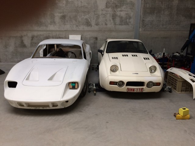

How tall are you? and am I correct in thinking you own this white mk2 as well as the one you're currently working on ?

Yes the Midas MKII is mine , but it's also the car where I am working on , how did you know that could be my Midas ?

I had thought you had another mk2 that you're working on, didn't realise it was that one, Brain a previous owner moved the subframe over and also spaced one side out a bit.ilmung wrote:Hhi Stuart , thanks for the reply !
