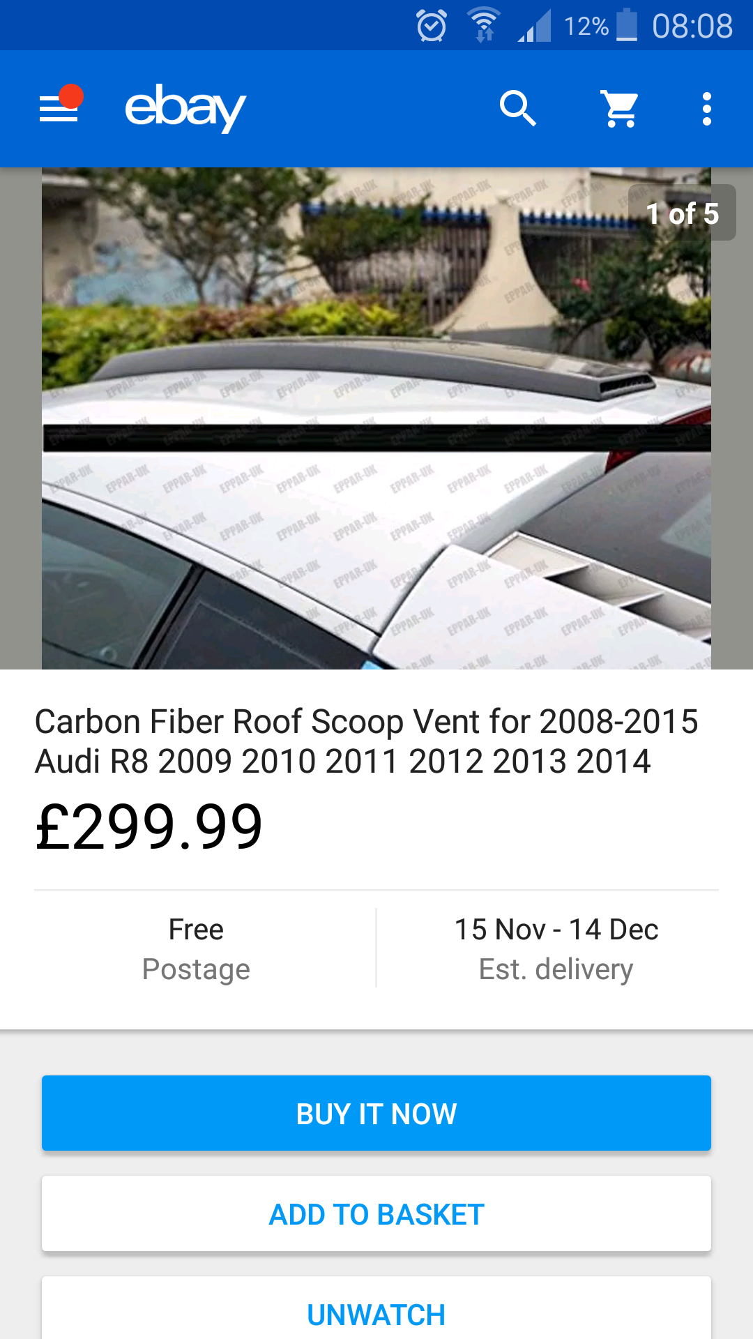

The only thing that springs to mind that I fancy is maybe a roof vent which suits my taste but I may also want to sell this one day so don't want to bastardise it too much.

- Screenshot_2018-10-29-08-08-02.png (787.02 KiB) Viewed 64604 times

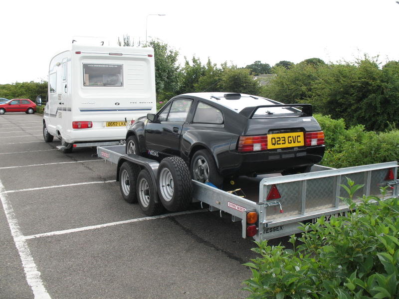

Jeff used a brake light housing to add a vent to his car, it seemed to help.
It was similar to this one

Mike Perkins has a grille in his parcel shelf with a fan to blow the air out through trunking.

When I worked in Nuclear Medicine at City Hospital, we used a 3 way tee piece connected to trunking when doing lung scans. The patient breathed in air plus a radioactive gas through a one way valve in the tee piece, and exhaled air went out through the other side via another one way valve. The valves operated on very small pressure differentials, patients breathing normally, and were essentially flaps of silicone rubber about 1mm thick. Such a valve in the outlet trunking would prevent gases coming back into the car, but not obstruct the outgoing air.
Mike found the system worked for him and demisted the rear screen.
