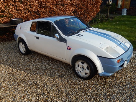

Postby mfdriver » Sun Jul 26, 2015 10:47 am
11" Coil Spring and 13" Revolution Wheels
13 inch wheels 1.jpg (124.13 KiB) Viewed 13205 times
Car is now for sale in For Sale page
This is how it sits
Malcolm
