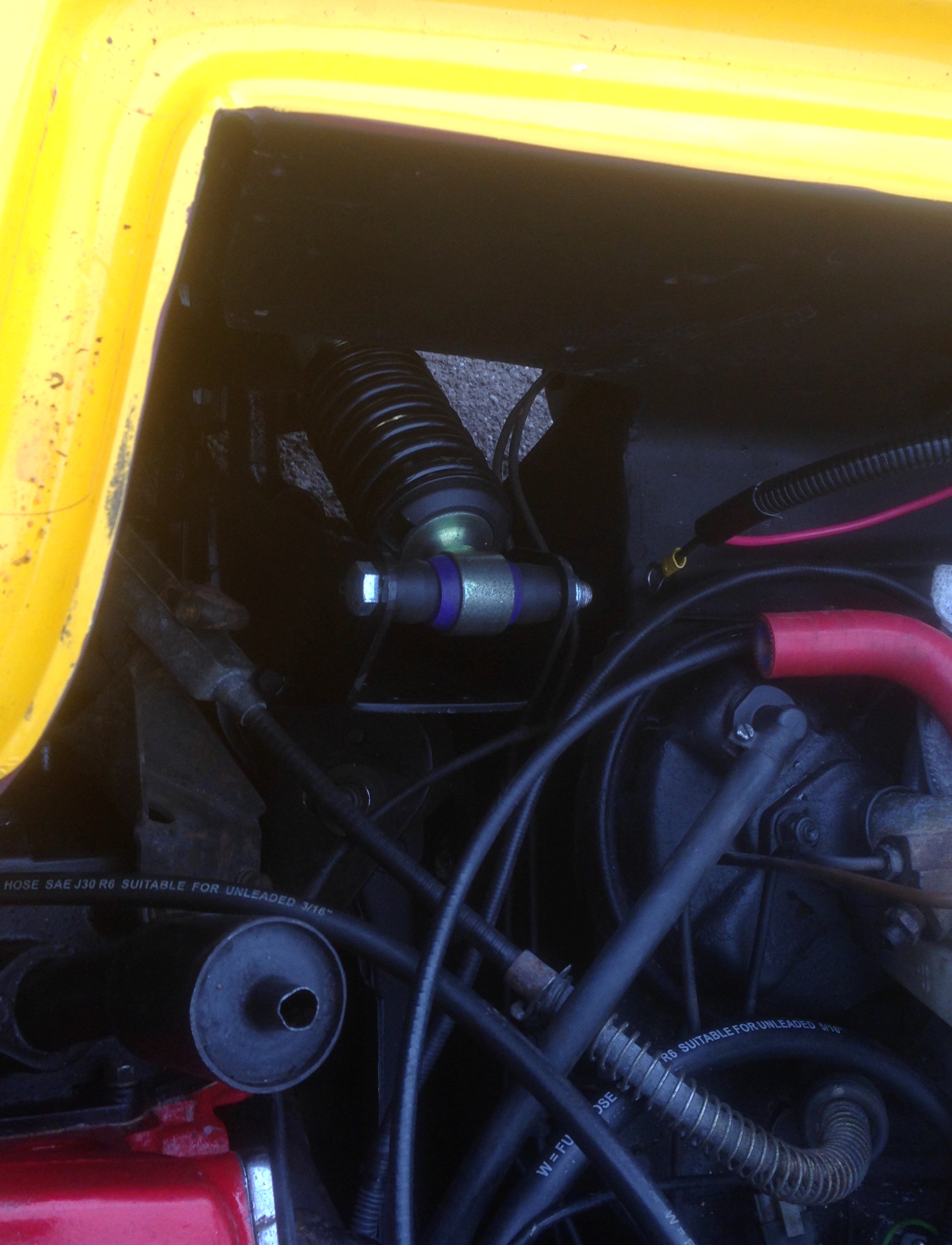

Postby DavidL » Tue Mar 08, 2016 10:29 pm
With the bracket for the lower end of the damper being above the top swivel, was there much of a problem getting clearance between it and the wheel rim?
Re: A different Coil-Over solution !
Postby axshack » Wed Mar 09, 2016 10:59 am
very good question DavidL, and it worried me for a while as I had not, as yet, fitted the wheels!! but just did so and there is at least 12mm clearance between the bottom of the damper mounting and the wheel rim - phew !! :)

Today, we managed to get the engine onto the subframe and both back in the car...bit of a faff, but we did it.
As I expected the battery box just fouls the top of the new suspension turret on the offside, but on the other side the expansion tank just clears it....magic - but more by luck than judgement if I am honest!
Next weekend will be start up and road test if all goes well !!
