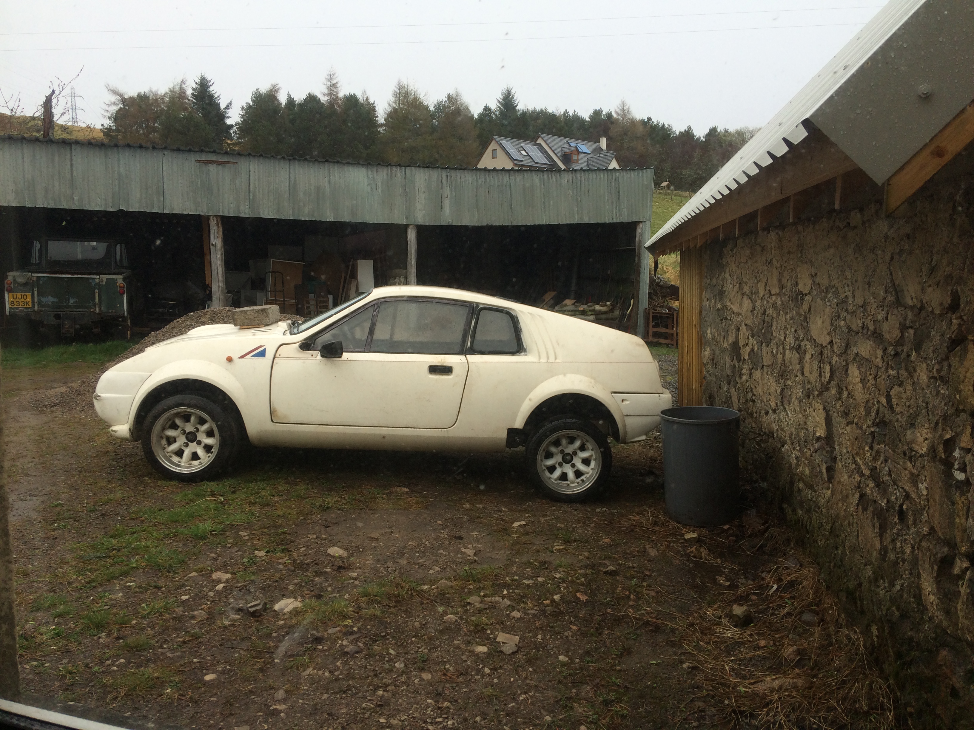

Postby centredonkey » Fri Apr 28, 2017 8:33 am
Our car now rolling again with all four wheels pointing in the right direction for the first time since we bought it!
Alas, now that the axle is sorted, the standard factory fitted Spax coilovers are making the arse end sit up even higher!
As they are banjaxed, I'm looking for a pair of bolt on replacements which will lower the rear at the same time
Any one found a good product that is currently available?
