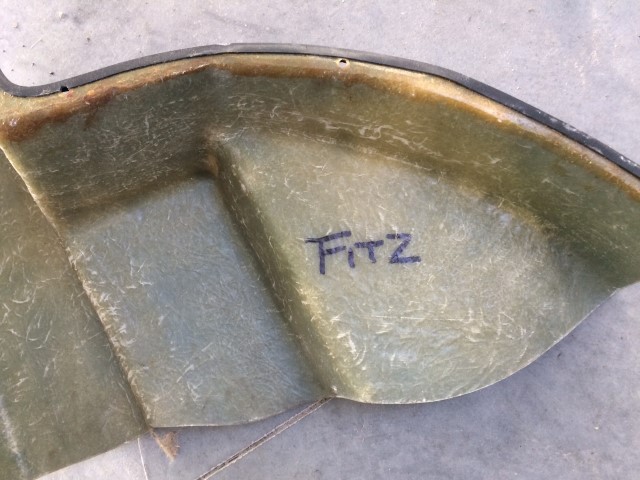

On different places I find a name ( I suppose ) of a person who has done the body grp , someone knew him ?

Postby Stuart » Fri Oct 12, 2018 8:08 am
The name on the panels is the surname of the original owner who ordered the car.

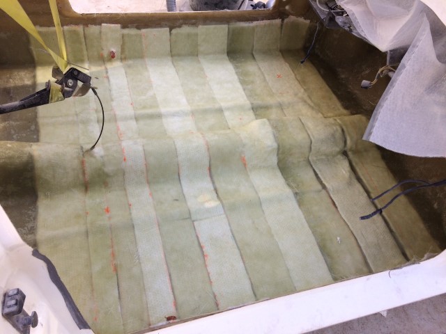

Postby ilmung » Sun Oct 14, 2018 9:22 pm
Today I have put some layers more for making the sandwish floor .
Feels much stronger than the original floor !
Next days I renforce the front and rear bulkhead , pictures follow !
