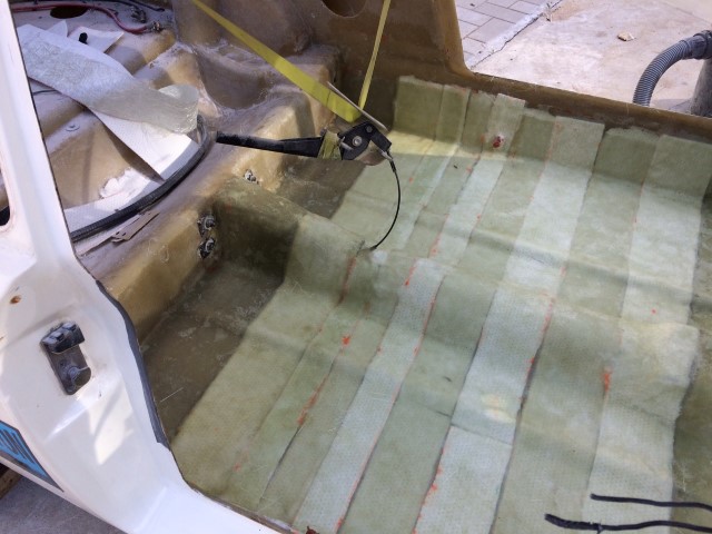

Postby ilmung » Sun Oct 14, 2018 9:22 pm
Today I have put some layers more for making the sandwish floor .
Feels much stronger than the original floor !
Next days I renforce the front and rear bulkhead , pictures follow !
