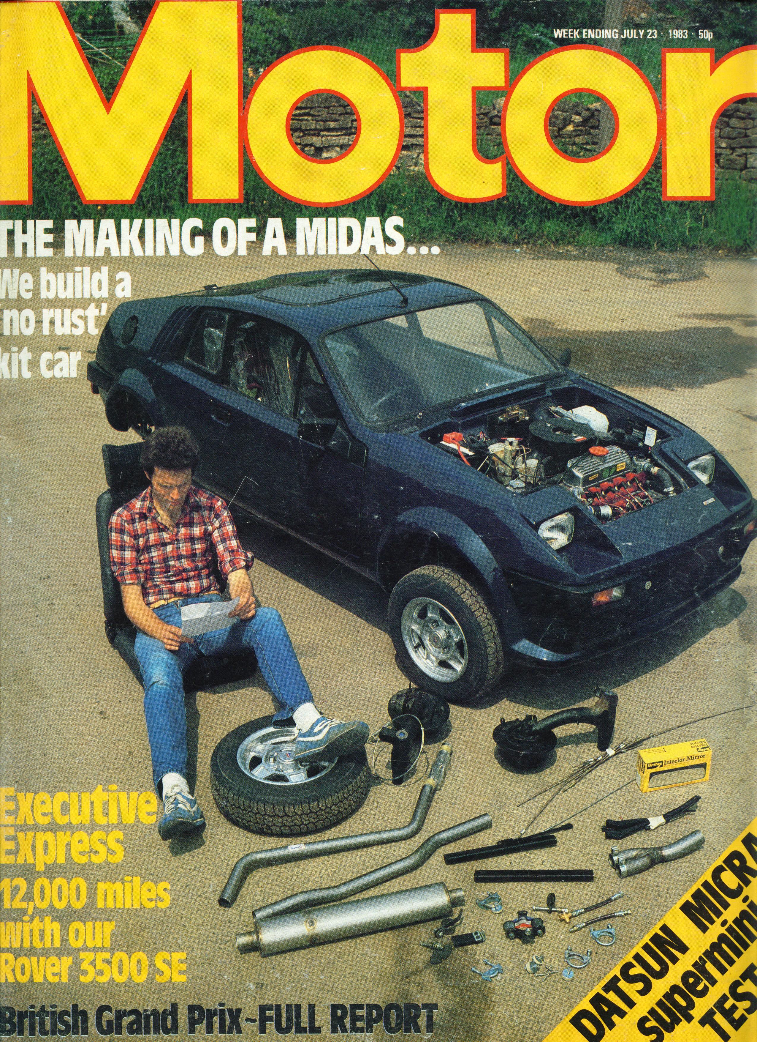

I'd say you'll need a ramp in the floor like Midas did for the late Russell Bulgin who was over 6' tall
- motor 0783 p01 (1).JPG (2.48 MiB) Viewed 64199 times
