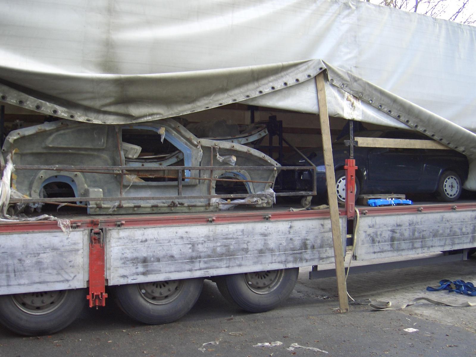

Gold Coupe Moulds coming back from Berlin

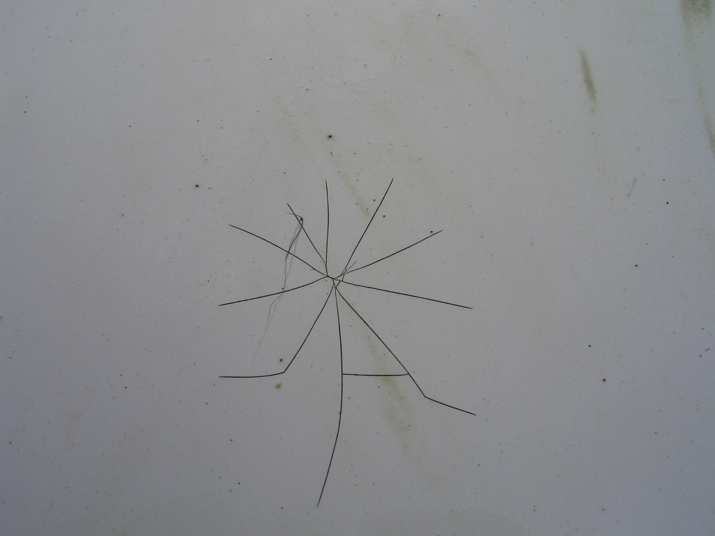

Star crack seen on Mk1 bonnet.
Unlike a lot of glass fibre bodied cars, the Midas monocoque should not develop stress cracks and the only inherent “design fault” may be found on the Mk1 bonnet, which could bounce on the top of the engine’s oil filler cap and the SU carburettor creating “ star-cracks” in the gelcoat of the bonnet. The bonnet of the Mk2 was redesigned to provide greater clearances and should not see the same issues.
That doesn’t mean that every Midas will be crack free, but rather that you should carefully inspect the body to look for any signs of cracks as any present will bear witness to misuse or mishandling. Bad cracks on the bumpers and body extremities are usually there as a result of accident damage, whilst cracks on doors or bonnets can be due to the panels being misaligned, or having been closed onto something hard.  Whilst a crack does signify a local weakness in the composite structure, it does not necessarily mean that the car should be avoided. Every crack is repairable and the structure can easily be returned to its original strength. However, the presence of a large number of cracks, or clear signs of accident damage, should be addressed as soon as possible and this should be factored into the purchase price.

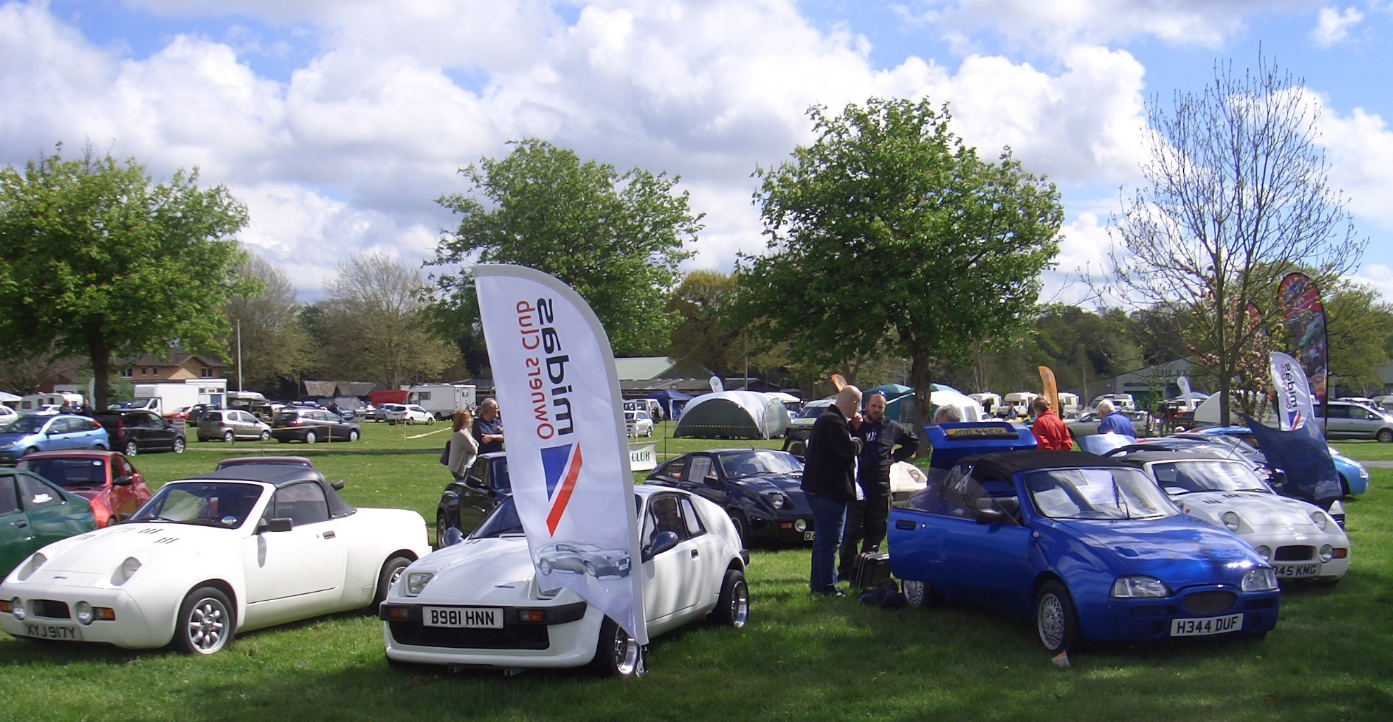

The best cars, that fetch the highest prices, are usually sold within the club, either through the club magazine, or the forum.  Typically this is because they have been taken to club events and seen by other owners and are therefore ‘known’ within club circles. If you are looking for a really good car, or a sound runner, then it is well worth putting a wanted ad on the club forum. It might just prompt an owner to sell his Midas to you.
Club meets, like the Stoneleigh show, are good places to buy and sell cars.
