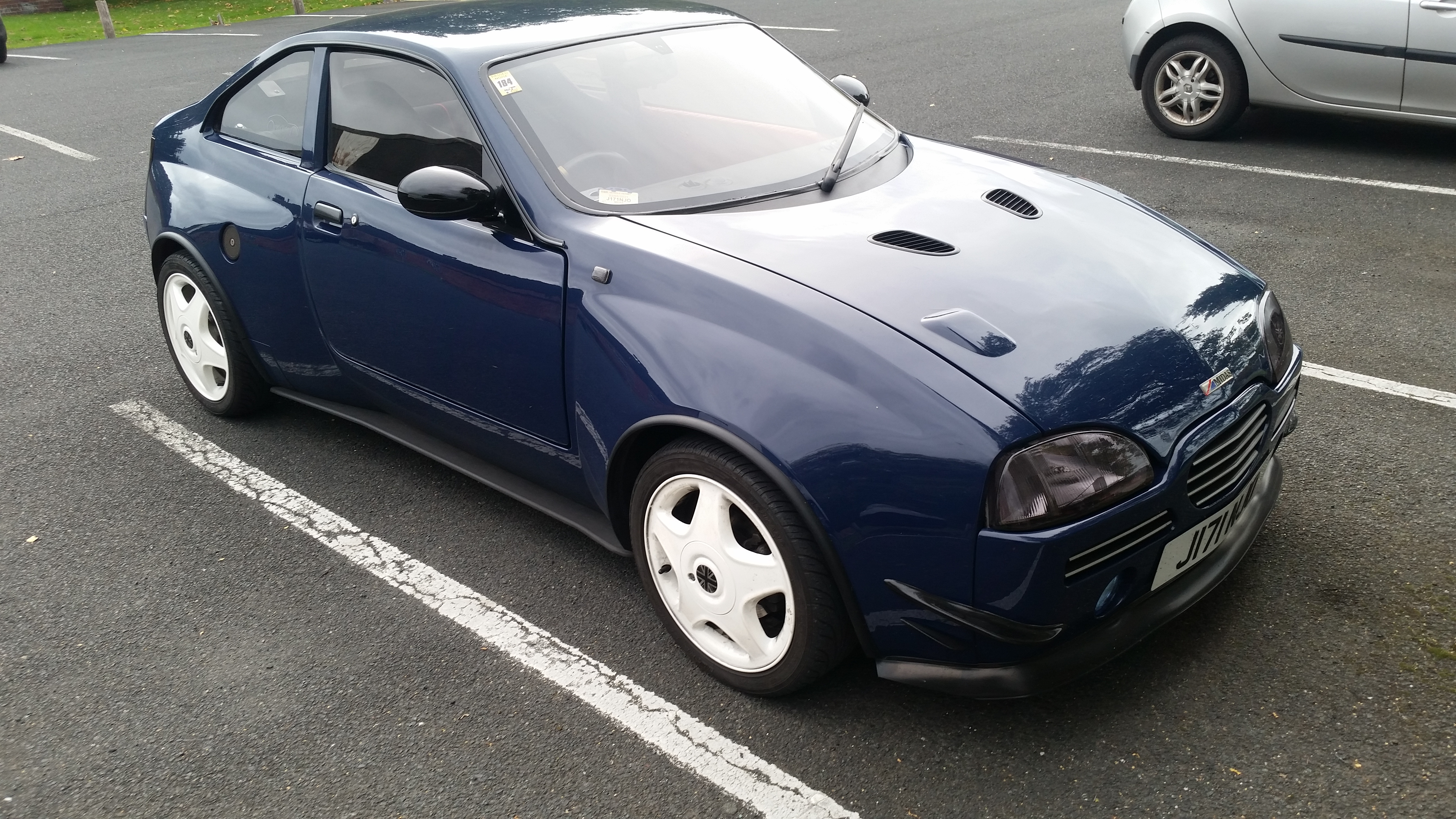

I'm 6'2" and fit in a mk4 / cortez no problem (although the physical activity of doing so raises some challenges LOL) and the front end can be manipulated to be slightly easier on the eye.
benofbrum
Posts: 255
Re: Is a Mini Marcos OK for a 6ft driver?
Post by benofbrum »
This is a massive picture on my computer and does not show the front of the car.
If you have the same problem, Rust Hater, go to Projects/N171NGO? page 10 and there are some good photos of the front.
In fact read the whole post, there has been a lot of upgrading on this car which has won best or most improved Midas at Stoneleigh for the last two years.

Embarrassing but I hadn't twigged that Mk4 = Cortez. One day I might find the front attractive but by then I'll have had to hand in my licence. Even the tweaked car, looks great from all angles except, to me, those headlamps. To me Mk1-3 look great but not the Mk4. Very annoying as otherwise it seemed the one for my asks. Oh well, like buying a house there need to be compromises but it needs to make me grin even just sitting on the drive. No matter, the pursuit can be part of the pleasure even if it is cars we are talking about. I will make an effort to sit in a Mk 1-3 to be sure this isn't a pipedream.
