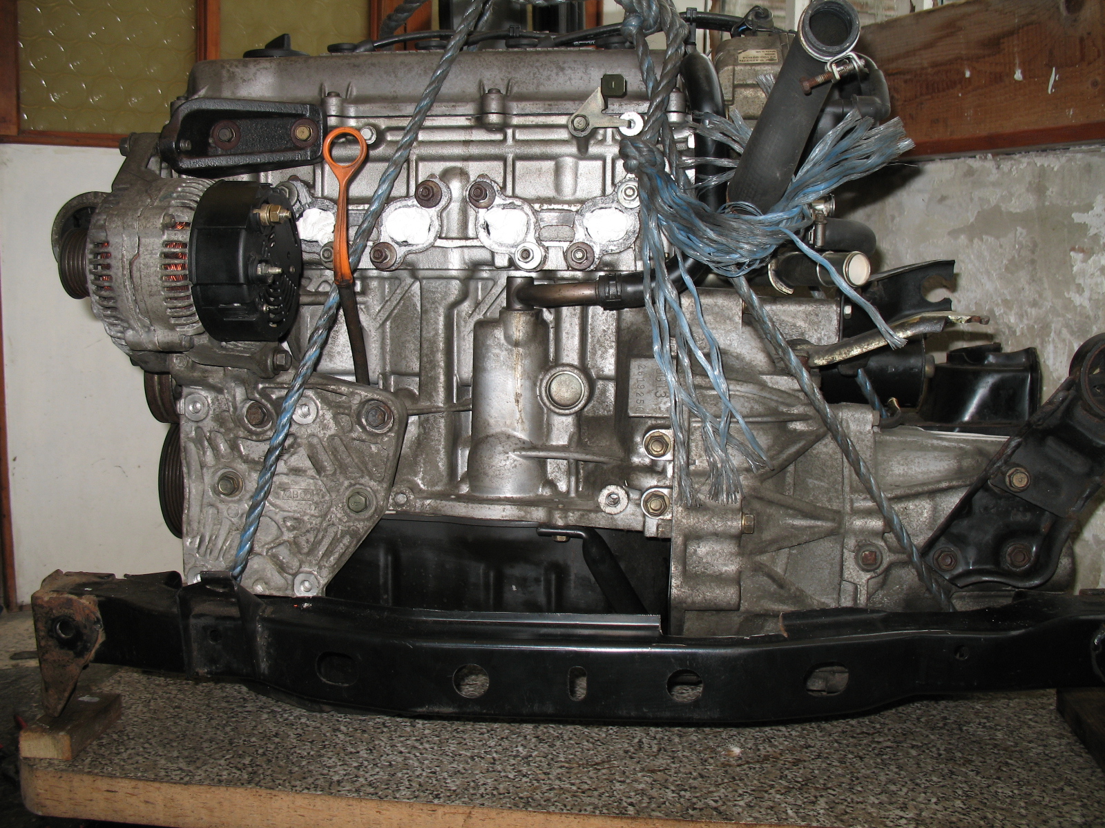

Last time I checked it it will fit.
npp 015 - Copy.jpg (1.13 MiB) Viewed 29998 times

Stuart wrote:Last time I checked it it will fit.
Are you doing the conversion as well then? I'm hoping i'll be able to find a 1.3 beater so I can just swap out what I need and sell the rest for scrap

Well if I ever get around to it that's a yes, struggling to find any motivation to get on with it. It'll make for a very nice car though.

I know that feeling but next year will be the year so my struggles may either help you or put you off even trying lol. After some rough doodles I think I'll be modding the subframe to fit the engine and have coilover suspension. I've decided I need to do a lot of maths to sort out the scuttle shake as well because its the 1 thing thats always irritated me

I've got one in my MK2

The engine encroaches into the o/s headlight so that needs a solution. The rest is just subframe mods

I've been thinking about the headlight issue and to keep the frogeye look I may look at changing from 7" headlights to 5 3/4" so they can move forward without looking like a choking frog
