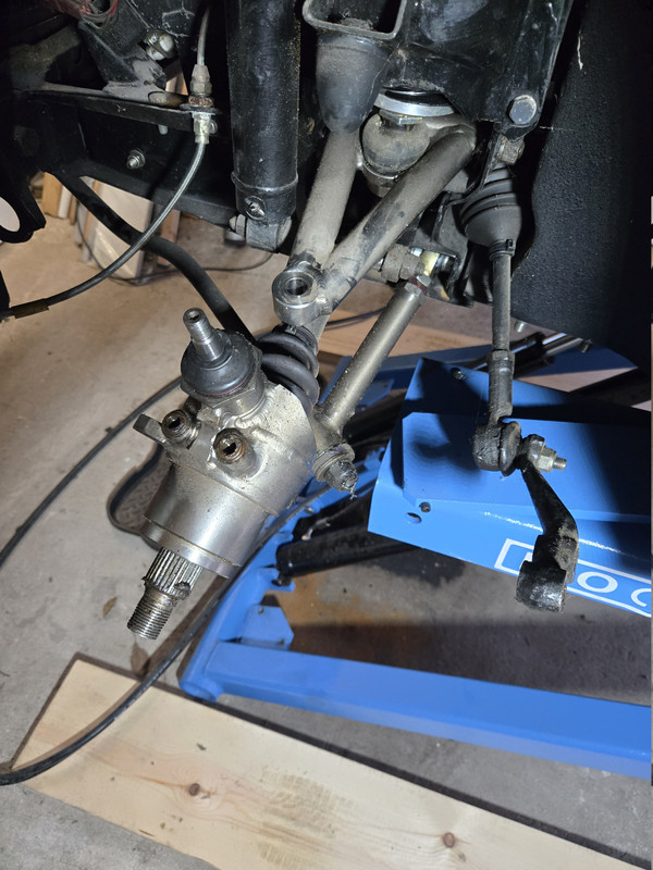

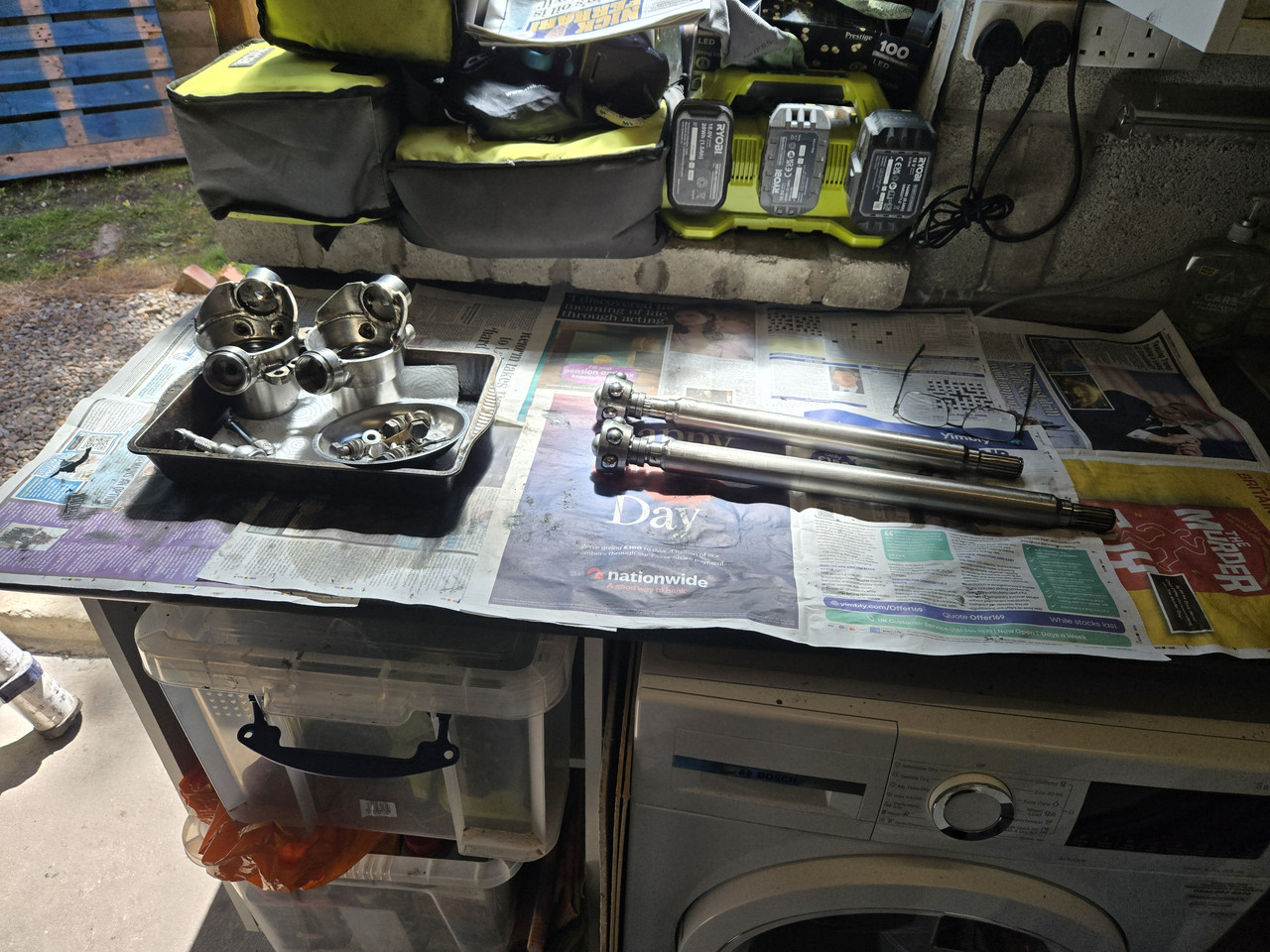

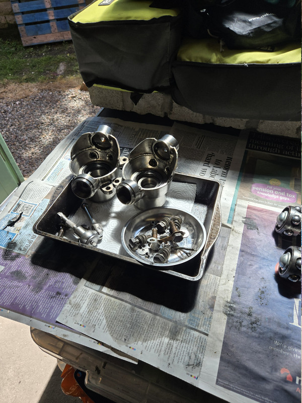

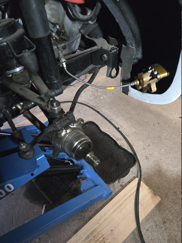

A bank holiday weekend brings a nice opportunity to do some more work on the convertible. Sadly replacing on the front bearings, cvs joints and balljoints. not because they are worn but sadly because all the rubber boots are cracked. Annoying with all this chinesium nothing seems to last.

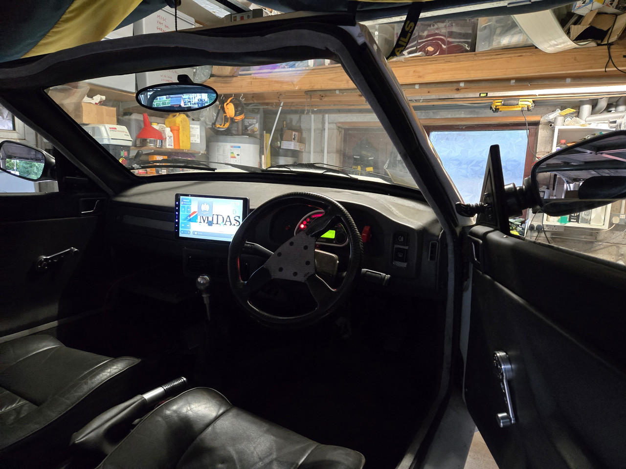

Also treated the car to some onboard navigation.

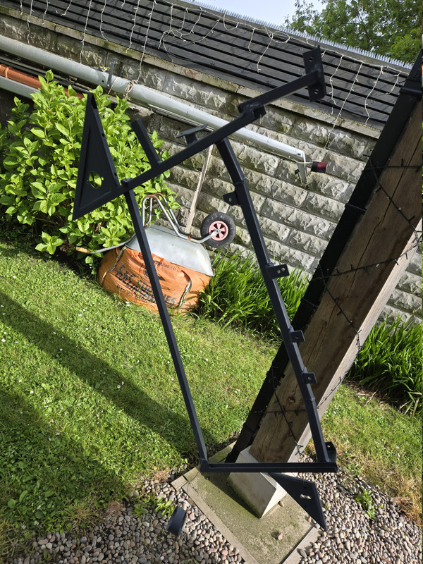

window frames given a recoat in black now looking for some decent window weathrstrips

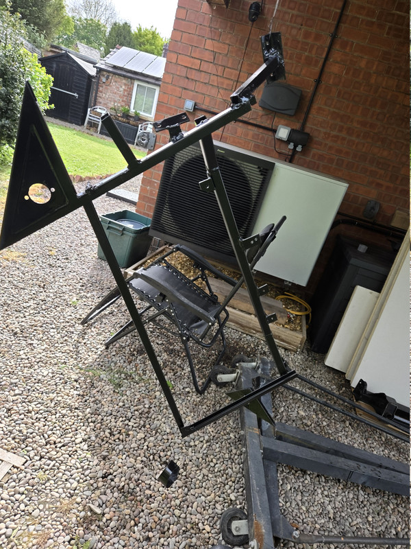

Well after a long hiatus I finally got the convertible back on the road and looking forward to driving her again.
MOtd nicely today with no advisories. Taxed for 6 months from tomorrow.
Have a few plans for it in the future as I want to change the subframe over and replanting the engine to another one I am building up using the lovely Mike Satur coilover conversion but want to spend some time actually driving her first :)
Thanks to Alan D for sorting out some items to get back on the road.
Happy Midas motoring.
